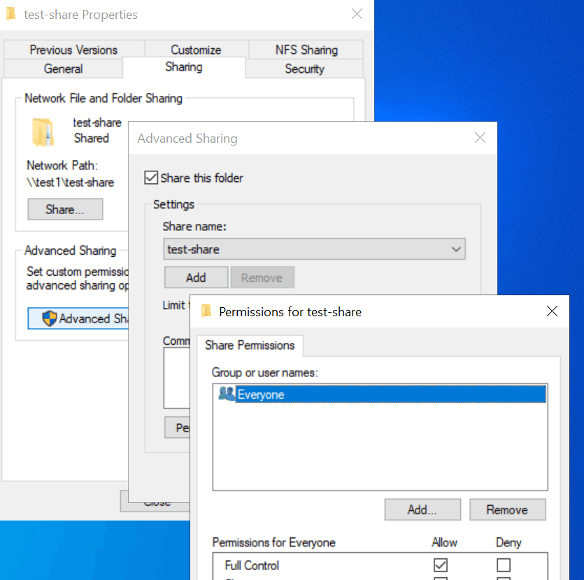

    Hello,
    windows 11 requires credentials by default for guest users to access shared files, and because insecure guest logins are not authenticated, important security features such as SMB signing and SMB encryption are disabled.If you do not want to access the shared file by logging in with a user and password. I recommend that you use Registry Editor to enable Insecure guest login, see the following steps:
    1. Open Registry Editor. Go to Computer\HKEY_LOCAL_MACHINE\SOFTWARE\Policies\Microsoft\Windows\LanmanWorkstation.
    Note: If the key does not exist, you need to create it. Hold down the "Windows" key (right-click), select "New" > "Key" and name the switch "LanmanWorkstation".
    1. Hold down the "LanmanWorkstation" key (right-click), select "New" > "DWORD (32-bit) Value" and name it "AllowInsecureGuestAuth". Double-click, set "Value Data" to "1", and press Enter.

    2024-12-25T01:05:13+00:00
    Hi Zunhui
    I see in your screenshot that you have a properties tab named NFS Sharing, this does not appear on any of my folder's properties.

    2024-12-24T15:54:00+00:00
    Hello,
    The credentials usually entered are the username and password of the other computer when it is turned on, unless you use other credentials to map the shared drive. In addition, I recommend that you check whether the share permissions and Ntfs permissions in the shared folders on both computers are consistent.
