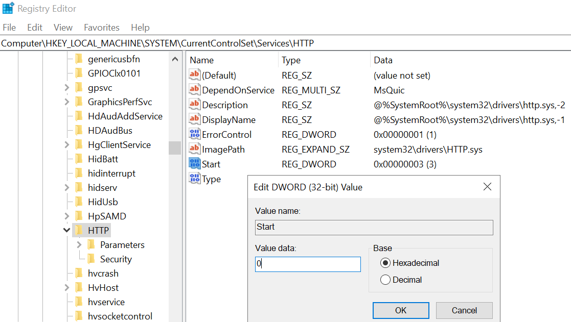

    If your computer has no other applications, I suspect that the system service is occupying port 443. I suggest you try to modify the registry to prevent the system service from occupying the port. Please refer to the following steps:
    1. Enter the registry editor in the search bar in the lower right corner of the computer and open it.
    2. Locate the location: Computer\HKEY_LOCAL_MACHINE\SYSTEM\CurrentControlSet\Services\HTTP
    3. Find the Start key in the right window and change its key value to 0.
    Note If you modify the registry incorrectly, you can cause serious problems. Therefore, follow these steps carefully. For additional protection, back up the registry before you modify it. For more information about how to back up and restore the registry, see How to back up and restore the registry in Windows.

    2025-01-18T05:34:14+00:00
    Hello,
    We tried this solution suggested by you but the issue has not been resolved.
    During last 10 days, we also have noticed that this happens at some particular time slots, like 11-11:30AM, 2-2:3PM & 5-5:30PM.
    With regards,
    Sagar Patel

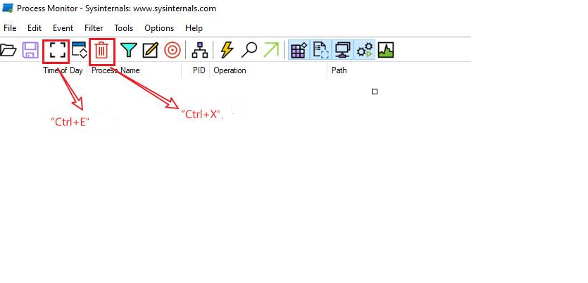

  5. Anonymous
    2025-01-24T09:43:29+00:00
    If you are sure that the problem will recur at a specific time, I suggest you open Process Monitor, press "Ctrl+E" to pause, and "Ctrl+X" to clear the current information. Press "Ctrl+E" again to start process monitor, and then run the program. Note the time point, press "Ctrl+E" in Process Monitor to pause, and press (Ctrl+S) to save the current log.
