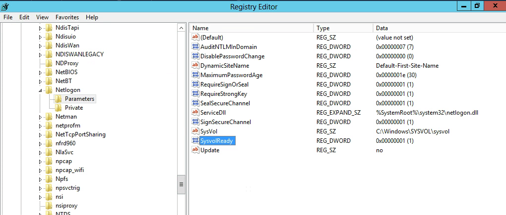

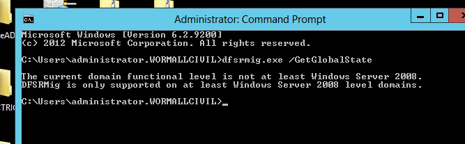

    2024-02-28T07:59:33+00:00
    Hi Daisy,
    Appreciate your quick response. I have tried to check whether the sysvol uses FSR or DFSR for replication. Below is the screenshot from Regedit.
    Also i tried to check the Sysvol replication through commnd line and see below error:
    What does the above screen shots specify about Sysvol replication. Does it use FSR or DFSR for replication?
    Please provide your comments.
    2024-02-29T02:05:36+00:00
    Hello Vinodkumar Vallur,
    Good day!
    DFS can only be used at the least 2008 functional level (or higher).
    It should be FRS in your case.
    Best Regards,
    Daisy Zhou
