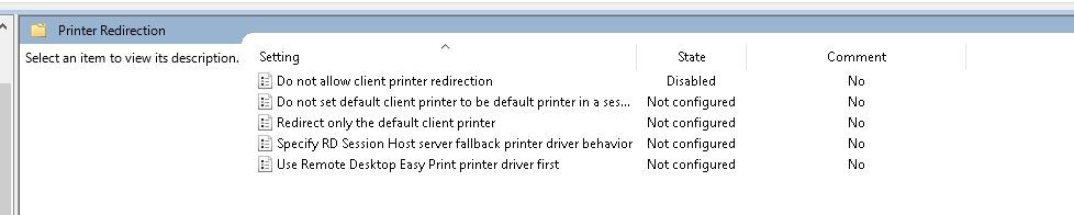

    2023-12-31T06:10:40+00:00
    Thank your for your response I tried to disable that policy also ..
    still its same and I attached reference even logs also from server..

    I'm sorry I miss this information before. I find “Do not allow client printer redirection” was disabled. Please try to enable this policy. Check if the issue persists.
