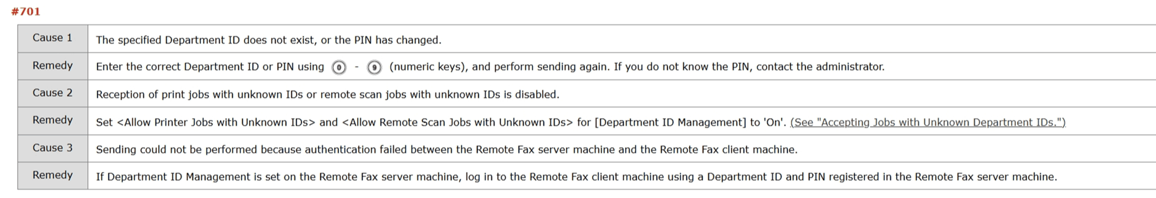

    According to my research, error code 701 occurs for the following reasons. Double check that the "Department Identifier" and PIN Settings on the printer match what is configured on the remote server.
    (Image source: List of Error Codes without Messages - Canon - imageRUNNER ADVANCE C3330 C3325 C3320 - User's Guide (Product Manual) )
