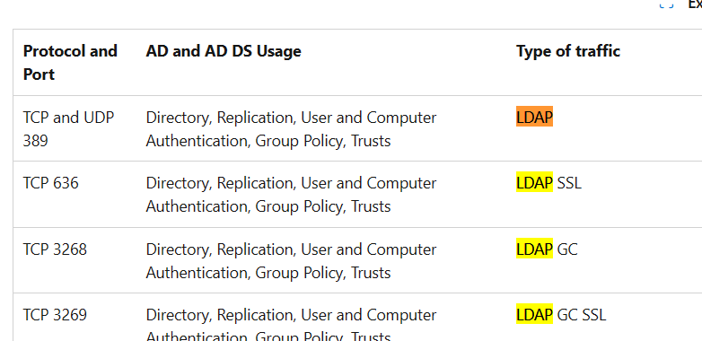

    Got error while checking LDAP and RPC connectivity. Please check your firewall settings. ............
    ............. SRV2016 failed test ConnectivityA: Please check the ports below replated to LDAP.![Image](https://filestore.community.support.microsoft.com/api/images/2387b191-107a-4c40-a426-052d2896573c?upload=true&fud_access=wJJIheezUklbAN2ppeDns8cDNpYs3nCYjgitr%2BfFBh2dqlqMuW7np3F6Utp%2FKMltnRRYFtVjOMO5tpbpW9UyRAwvLeec5emAPixgq9ta07Dgnp2aq5eJbnfd%2FU3qhn54Ui9c7IY3%2BVaDGM794ieFEWFOTytTrMKy7m1XQpeIKlfhHZvv6qxFNypZh8EVO%2BjzMgLRnj7SrY%2FjVoV7qs8fDiK994oMxVrhrFAMYDcU%2FzogdRJ8k9kOw3Q%2BU%2FGeslSgd2IBCo025t1Hqe7hQ8XgHv7IHb8zgPlh1Sz6rBw0YEeJO%2Bs2bgMLPdqfw%2BBrnawediUNOQvhbFT4Amcf9P8otQO%2Bfc668T096haKArALyvLJH%2B3LhYaPyYy8REhDNNRSkJzMFuSzfgeg1DpI0yP9sCLaWvVVV7Fc6M9NfkXSMB4%3D)
    And the ports below related to RPC.Image
    And the new default start port of RPC is 49152, and the new default end port is 65535.  Therefore, you must increase the remote procedure call (RPC) port range in your firewalls.
    Active Directory and Active Directory Domain Services Port Requirements | Microsoft Learn
