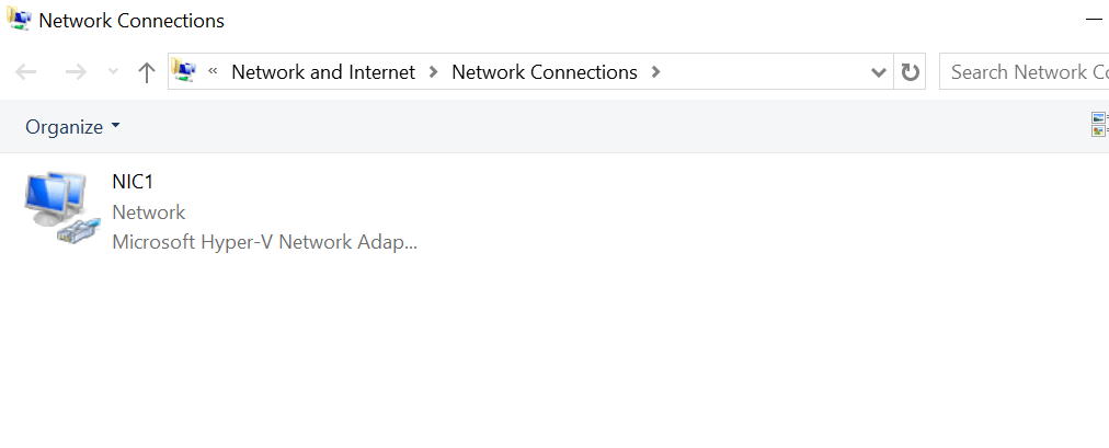

    1. Check Network Adapter Settings:
    • Ensure both your Wi-Fi and LAN adapters are properly configured and not conflicting. Open Network and Sharing Center, check the adapter settings, and ensure the bridge connection is active.
    2. Verify Bridge Connection Configuration:
    • Open "Control Panel" -> "Network and Sharing Center" -> "Change adapter settings".
    • Confirm that your Wi-Fi and LAN adapters are correctly bridged. Try deleting and recreating the bridge connection.
