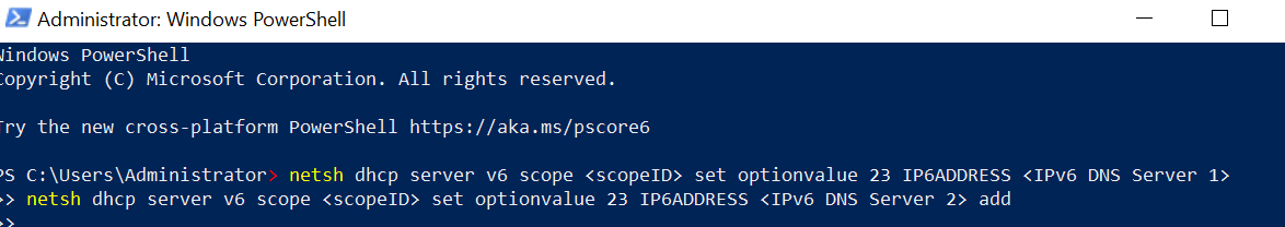

    Step 3: Configure Option 23
    If directly setting via the GUI does not work or you need to verify the command line:
    1. Open PowerShell or Command Prompt as Administrator.
    2. Use the following commands to add the DNS server addresses to your DHCP scope: netsh dhcp server v6 scope <scopeID> set optionvalue 23 IP6ADDRESS <IPv6 DNS Server 1> netsh dhcp server v6 scope <scopeID> set optionvalue 23 IP6ADDRESS <IPv6 DNS Server 2> add
    Replace &lt;scopeID&gt; with your specific scope identifier and &lt;IPv6 DNS Server 1&gt; with the actual IPv6 DNS server addresses you wish to use.

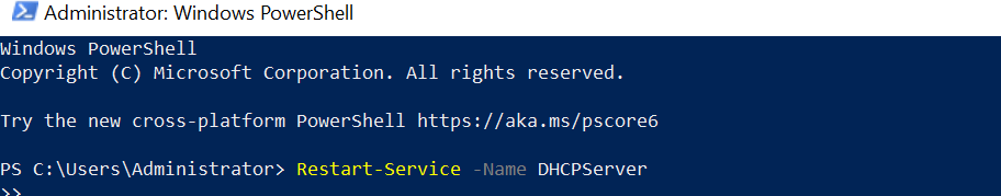

    Step 4: Restart DHCP Service
    After applying the changes, restart the DHCP service to ensure all configurations are applied correctly:
    Restart-Service -Name DHCPServer

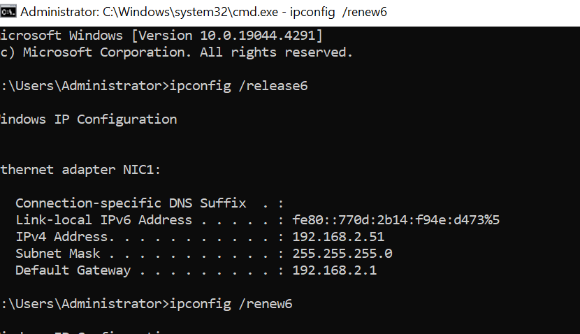

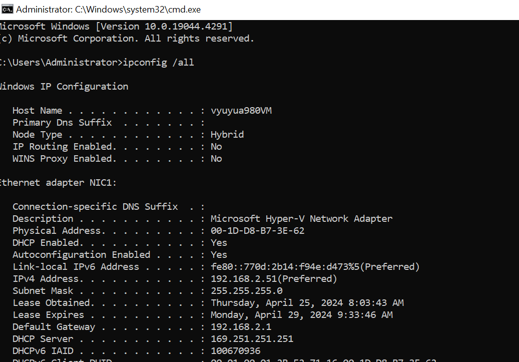

    Step 5: Verify on Client Machine
    On a client machine, after ensuring it is set to receive IPv6 addresses and DNS information via DHCP:
    1. Release and Renew DHCP Lease: ipconfig /release6 ipconfig /renew6
    1. Check Configuration: ipconfig /all
    Look for the DNS servers under the IPv6 configuration to verify that the correct settings have been applied.
