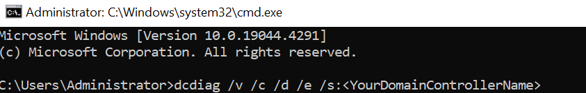

    Run DCDiag
    DCDiag is a diagnostic tool that can help identify and resolve issues with Active Directory. Please run the following command to check the status of the domain controller:
    1. Open Command Prompt as Administrator.
    2. Enter the following command and press Enter: dcdiag /v /c /d /e /s:<YourDomainControllerName>
    Review any errors or warnings in the output and address them as indicated.

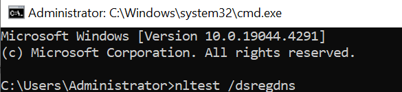

    NLTest can help check and register DNS records. Please run the following command:
      nltest /dsregdns

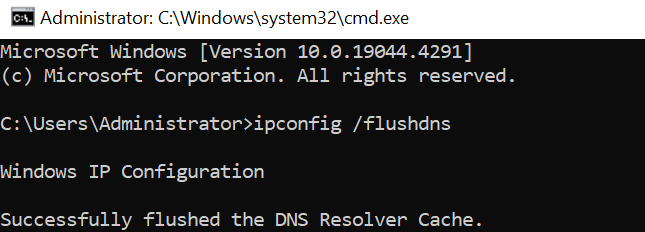

    Clear and Re-register DNS Records
    2. Enter the following command to clear the DNS cache: ipconfig /flushdns

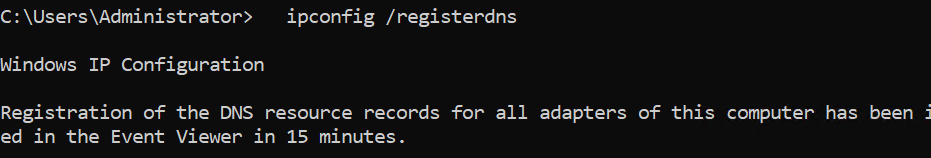

    1. Enter the following command to force DNS records re-registration:
      ipconfig /registerdns
