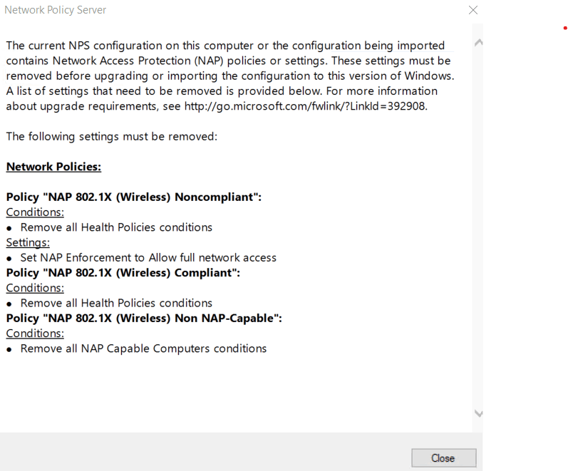

    Thanks for the feedback. My colleague would have upgraded our AD DC and the DC with the NPS was demoted to a member server. As a result I am thinking that is why Radius Auth is not working. As a result I am thinking that the best approach is to just export the config and install onto the NEW DC after I add NPS to a new DC .
    So I added NPS to the new DC and now I get this message when I try to import the config.
    Do not matter what I try, I am unable to import the config.
    What am i missing ?
    It must be noted that when I click on policies on the left of the NPS , in the MMC it shows no policies on the right side ?

    You can try to copy the NPS configuration to another NPS using the following Netsh command:
    1. On the source NPS, open Command Prompt, type netsh, and then press Enter.
    2. At the netsh prompt, type nps, and then press Enter.
    3. At the netsh nps prompt, type export filename="path\file.xmlexportPSK=YES, where path is the folder location where you want to save the NPS configuration file, and file is the name of the XML file that you want to save. Press Enter. This stores configuration settings (including registry settings) in an XML file. The path can be relative or absolute, or it can be a Universal Naming Convention (UNC) path. After you press Enter, a message appears indicating whether the export to file was successful.
    4. Copy the file you created to the destination NPS.
    5. At a command prompt on the destination NPS, type netsh nps import filename="path\file.xml", and then press Enter. A message appears indicating whether the import from the XML file was successful.
