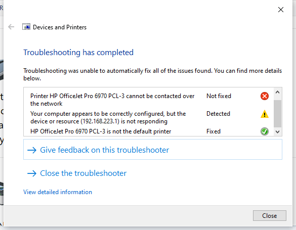

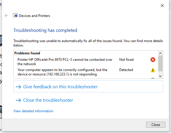

    I ran Printer Troubleshooter....and here is what it showed..... When I open Device and Printers/Control Panel it shows this printer is set as default. When I open ALL SETTINGS/Devices/Printers...it shows the Printer and shows it as Default. I have the PC and the Printer ethernet connected to our Modem\Router...so its been a Network printer for years. I decided to power off PC and Printer. ReBoot the ComCast Modem\Router. Waited for Modem to complete Bootup. Powered on PC and Powered on Printer.... Made no difference...printing a test page or Pinting from Word...job goes into Printers Que...but does Not Print.
    2024-10-31T17:46:07+00:00
    Windows 10
    HP OfficeJet Pro 6978 Printer....set up connected to Router so it is an accessible Network Printer. Printer is definitely Power On, and connected to Router....

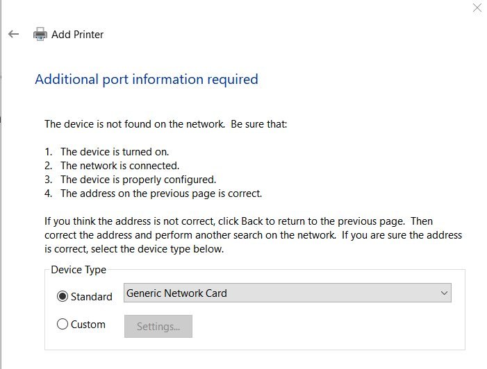

    Followed steps to manually configure Printer ...only step not cercern of...at one point came to a windows asking use Installed Driver (recommanded) or replace driver...I left it at Use Installed driver.
    Completed all the other on screen instructions. I do see the Printer in Device and Printers now...when I click Print a Test Page....the print job goes to the Printers Que...I see it there, it does not Print.
    I ran Printer Troubleshooter....and here is what it showed..... When I open Device and Printers/Control Panel it shows this printer is set as default. When I open ALL SETTINGS/Devices/Printers...it shows the Printer and shows it as Default. I have the PC and the Printer ethernet connected to our Modem\Router...so its been a Network printer for years. I decided to power off PC and Printer. ReBoot the ComCast Modem\Router. Waited for Modem to complete Bootup. Powered on PC and Powered on Printer.... Made no difference...printing a test page or Pinting from Word...job goes into Printers Que...but does Not Print. ImageImageImage
