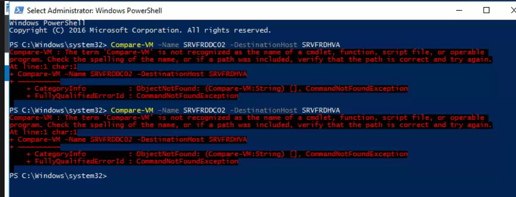

    HI thank you for your response,
    Could you please let me know where I have to run the below commands. (I have tried to run below command inside source VM as well as destination host server but getting the error)
    Compare-VM -Name VMname -DestinationHost xxx
    (Compare-VM -Name VMname -Destination Host xxx). Incompatibilities | fl *
    We removed VM from cluster and try to move to destination Host getting an error "The operation failed with error code '32784'"
    But when we turn off the VM and tried to move it to destination host it's working without any issues.
    I checked CPU and Patch levels are good on Source and destination We will try to disabled antivirus and let you know the status
