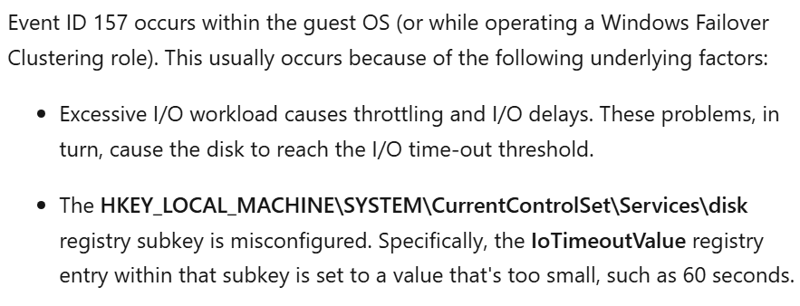

    2024-10-02T10:23:22+00:00
    Hello,
    The disk disappearance most often occurs when something disrupts communication between the system and the disk, such as a storage area network (SAN) fabric error or a Small Computer System Interface (SCSI) bus problem.
    I suggest you refer to the following links for troubleshooting:
    Disk <number> has been surprise removed (event ID 157) - Virtual Machines | Microsoft Learn
