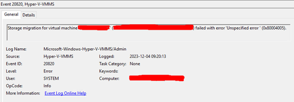

On Standalone S2D (not Azure Stack) cluster after shut down cluster (gracefully with all procedures) before power outtage happen while i run all envirtment i can't do storage migration. VM has shared vhdx (vhdx set) with another VM. I tried do storage migration from vm 1 and vm 2, from Failover Cluster MMC, from AdminCenter all time with the same error. In web i only found information about problem with replication between 2 nodes, or connected iso, but affected vm are not replicated and iso are disconnected and removed. At this moment shutdown vm and re-attach disks in not allowed. This is SQL cluster vm. Can someone help with this issue?

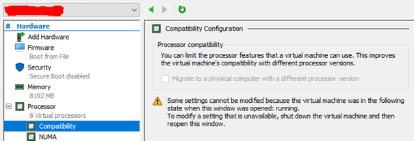

    i don't have green light to restart vm-01. First maintenance window will be on 1st week of January. I meantime i changed in vm-02 (this server i can restart) compatibility and tried to run storage migration but problem was the same. Can we try something more before January?

    Thank you for update. Restart vms is planned for tommorow. I will add the option to both vms and i will update you.

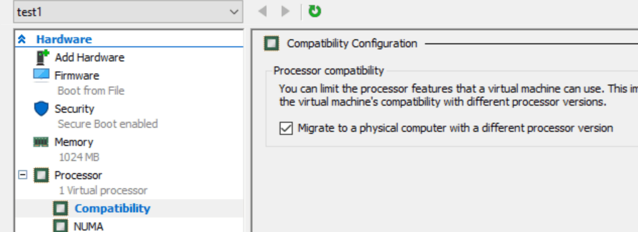

    Based on the information provided, I have summarized the following possible reason for your reference:

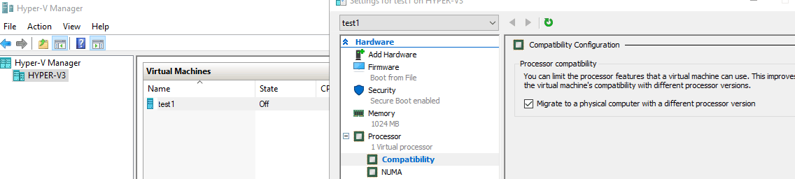

    According to the screenshot you attached, It is possible that VM -01 has a configuration problem. You can select the options below and try storage migration again to check whether it is feasible:
    Please let me know whether it is feasible.

    Please check the following configuration, right-click question machine, select “settings”, and check the “Processor -> Compatibility”:
    All vms in cluster have the same compatibility

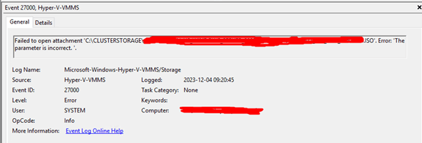

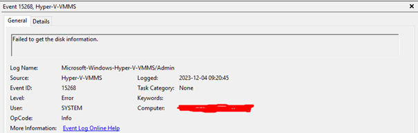

    I found only:
    I checked vm on host-03 and all vm don't have attached .iso. host-03 is also not have connected .iso. Fires screenshot happen while i try run storage migration.

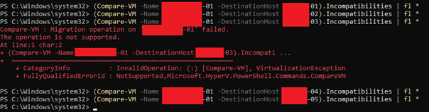

    (Compare-VM -Name xx -DestinationHost xx).Incompatibilities | fl *
    I have only error with 1 host

    Due to possible compatibility issues, please open PowerShell and then input the following command:
    Please provide us the screenshot. Thanks.
