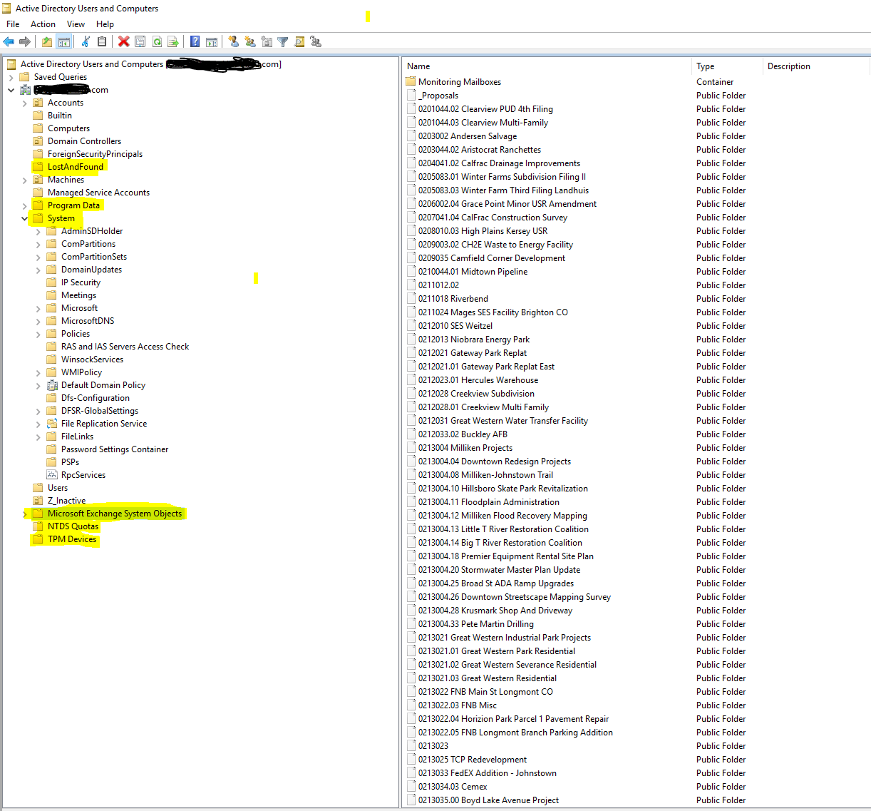

    I have another concern: after the migration which went just fine with no error, I noticed that they are some folders that were on the old DC that did not move to the new DC. The below picture is my old DC tree. the highlighted folder are those that did not moved over to the new DC. Some of them are empty, but the once that I have concern with are System and Microsoft Exchange System Objects (there are some public folders in the second one). there are many information in the System folder. Do I need to migrate them over to my new DC? if yes, How?
    thank you very much for your help.

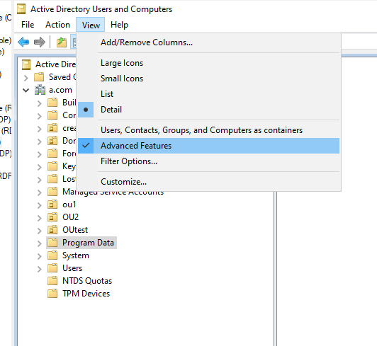

  5. Anonymous
    2024-01-25T03:31:54+00:00
    Hello RSHAH_1501,
    You can try to check the option "Advanced Features", then you will see the highlighted folder you mentioned.
    If you have any question or concern, please feel free to let us know.
    Best Regards,
    Daisy Zhou
