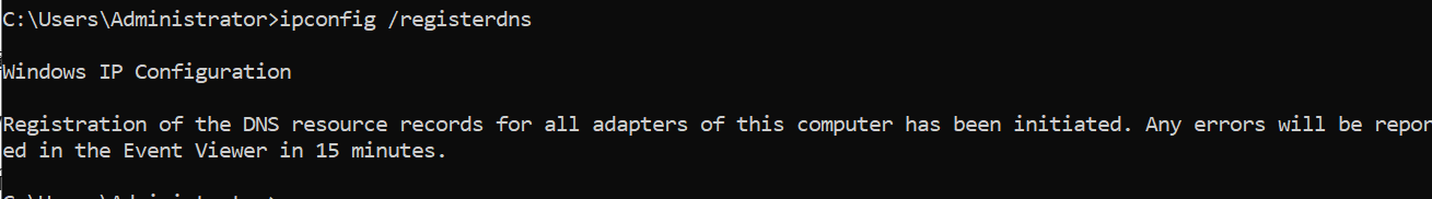

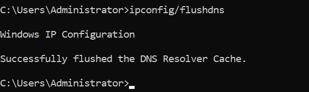

    4. DNS Flush and Register:
    • On the VPN server, you can attempt to flush the DNS resolver cache (ipconfig /flushdns) and then register the DNS records again (ipconfig /registerdns). This can sometimes resolve issues where stale DNS records are causing resolution problems.

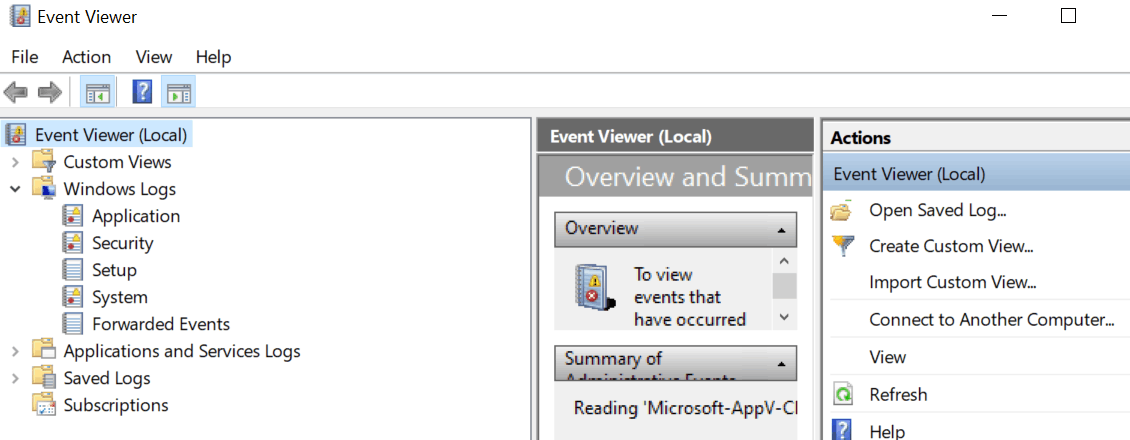

    5. Event Logs and Error Messages:
    • Check the Windows Event Viewer for any network-related errors or warnings that could provide more insight into what might be failing. Look specifically under the System and Application logs.
