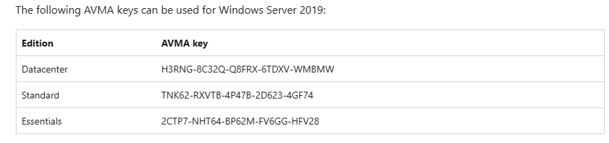

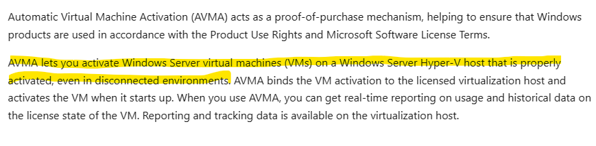

    Is your Hyper-V host a Datacenter edition?
    If it is, you can use Automatic Virtual Machine Activation (AVMA) to activate the VM.
    To activate VMs with AVMA, you use a generic AVMA key (detailed in AVMA keys) that corresponds to the version of Windows Server that you want to activate.
    If it isn't, you should be able to use the same key you used to activate the Hyper-V host to activate the VM.  If the host was activated with an OEM key, contact the OEM for a key to activate the guests.
