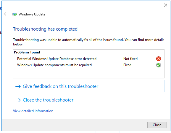

1.) Ran Windows Update Troubleshooter:

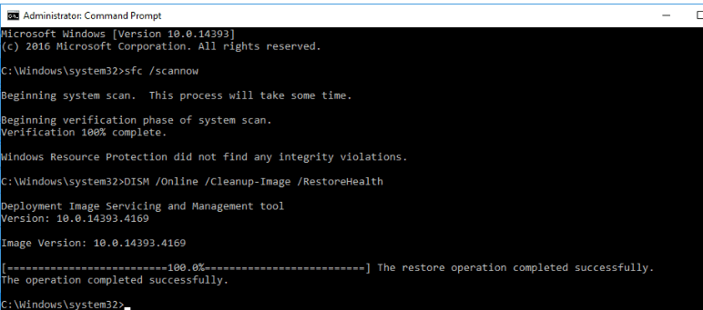

4.) Ran sfc /scannow and DISM /Online /Cleanup-Image /RestoreHealth
These were the results:
We have rebooted the server multiple times in between these steps. Do you have any other suggestions? Thanks.
