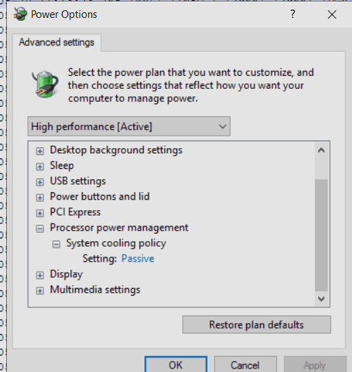

    2024-05-22T08:55:43+00:00
    Hi Molly,
    Thanks for your response. Based on the suggestions from your side. Following are my updates:-
    1. Spark is already set to high priority , i confirmed from the task manager itself.
    2. After switching to high performance, now such power plan setting is there. Here is the screenshot of the power options.
    3. I am not using SQL server, all the work is done on local machine only,
    4. I also checked the Spark jobs , it is detecting all the 16 CPUs but not able to use it efficiently.
    5. Affinity of the program is already set to use all the cores.
    6. I am running the same program on Linux also, all the configurations are working fine there utilising all the CPU cores.
    I need further help to tackle this issue. Any suggestion is highly appreciated.
