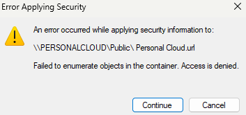

    2024-12-23T04:35:45+00:00
    Hello,
    That didn't work either, please see below screenshot of the error. I tried with and without the inverted commas. Windows is up to date

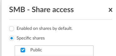

    I have checked the Seagate drive and it looks like it is sharing correctly
