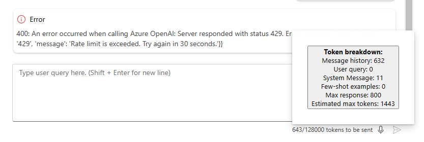

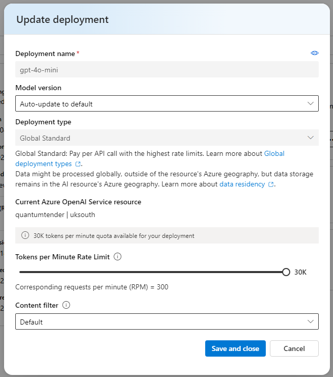

Using Azure OpenAI, I have deployed a model gpt-4o-mini
Tokens per minute set to 30k (the maximum allowed in my case). Corresponding requests per minute = 300.
In AI playground, when chatting without an AI Search data source connected, it behaves OK.
As soon as the AI Search is connected, I can send one or two prompts before receiving the message Rate Limit Exceeded.
The AI search service is on the Basic Pricing tier and I cannot see anything under monitoring that would suggest an issue
Please explain the cause of the rate limit being exceeded. The message in the playground links to the deployed model, which has settings at max.
There is nothing in the AI search service to suggest limits are being reached.
As it stands, this is unusable in an application where we want to use the model's NLP to serve content from documents indexed by the AI search service.

  1. Alistair Thomson 30 Reputation points
    2025-03-10T07:55:31.9466667+00:00
    For anybody else having this issue, we increased the max allowed TPM for the model deployed in Azure Open AI in the region where it is deployed (UK South).
    To do this we had to make a request directly to Microsoft, indicating the subscription, model and region.
    To make this request, we used this link: https://aka.ms/oai/stuquotarequest
    As a result, the max allowed TPM for this model was increased from 30K TPM to 2M TPM. We have set it around 250K and it is now working fine.
    In my opinion this suggests that the default upper limit of 30K TPM is insufficient for AI workloads with the gpt-4o-mini model connected to an AI Search data source.

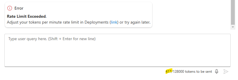

  2. Alistair Thomson 30 Reputation points
    2025-03-06T08:01:51.11+00:00
    Thanks for the response.
    I've create a new Azure Search service in standard tier pricing and recreated the index. I've attached this as the data source in the chat playground.
    Unfortunately the suggestion made no difference other than the specific error message returned.
    This error occurred at the third prompt in the chat playground.
    Please advise.
