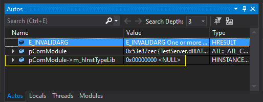

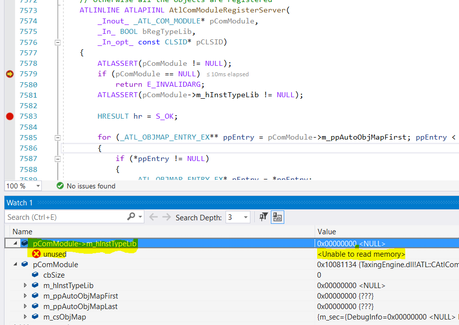

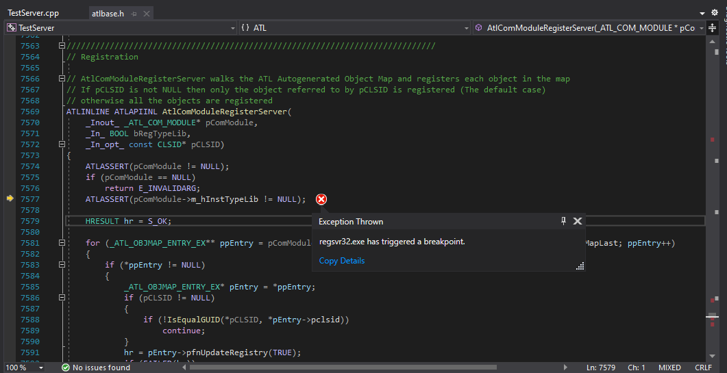

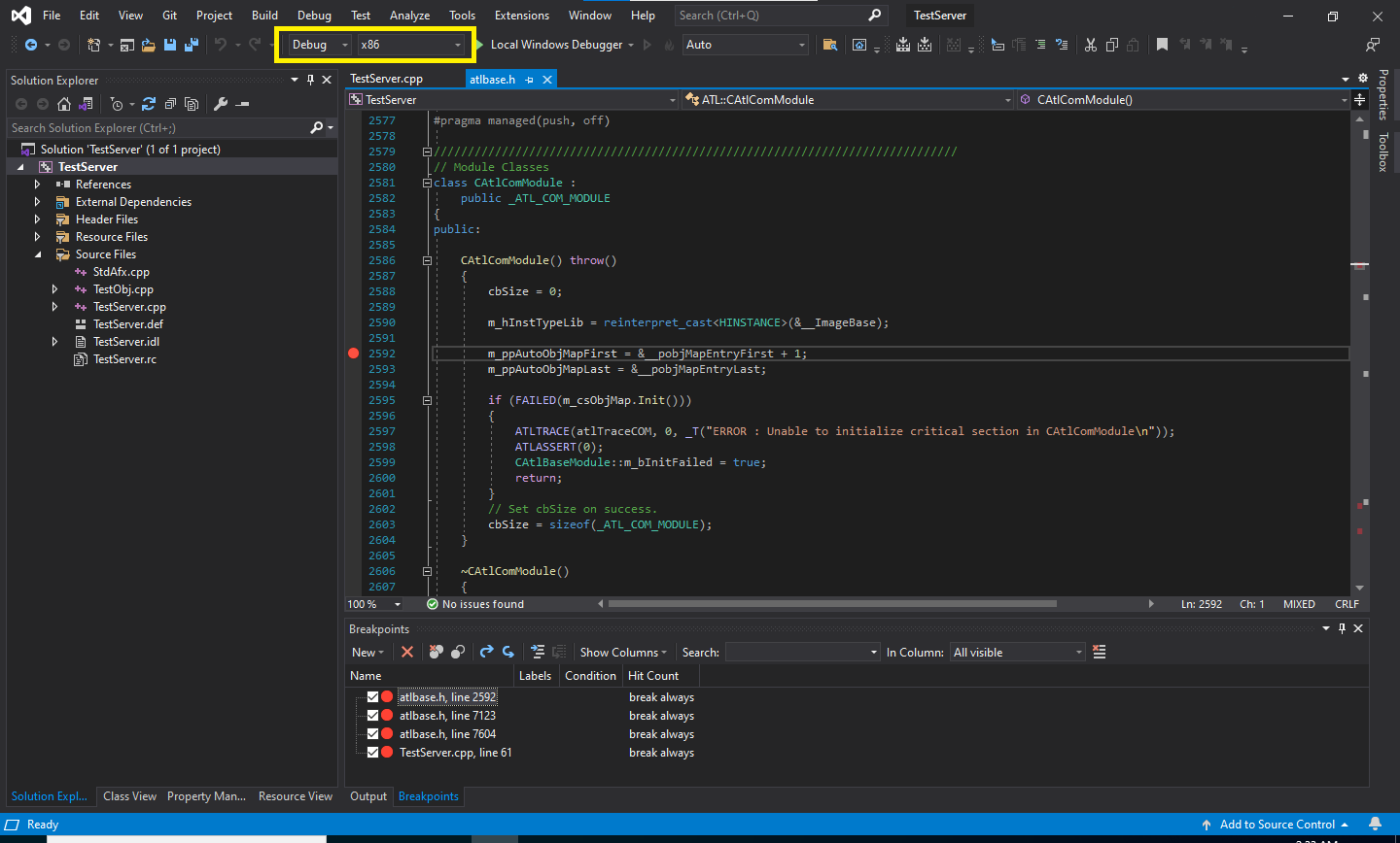

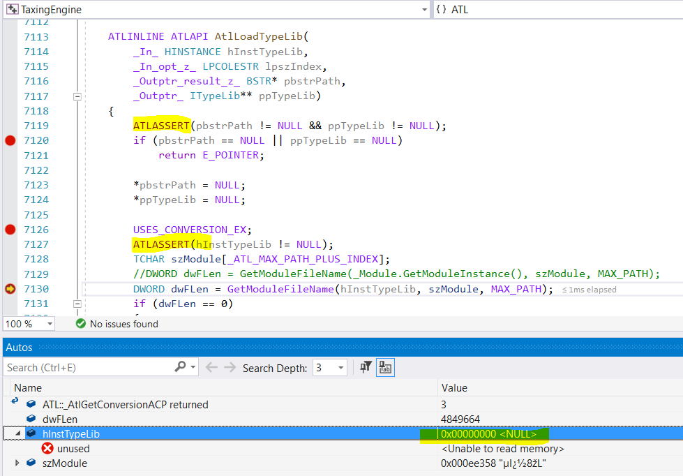

Debugging Registration: I added MessageBoxes to debug the registration process and found that:
If I pass a hardcoded path to the LoadTypeLib(defined inside ATLBASE.H), the type library registers successfully.
regpath
Issue with _AtlComModule.m_hInstTypeLib: On further debugging, I discovered that _AtlComModule.m_hInstTypeLib is pointing to the path of regsvr32.exe instead of the DLL path.
hinstance
I checked another similar project (with identical settings) that registers without issues, and its hInstance correctly points to the DLL path, not regsvr32.exe. This makes me think that something in the build or project settings might be messing up the module instance handle, but I can't figure out what could be causing this.
What could cause regsvr32 to fail with exit code 5 (Access Denied) or 0x80029C4A, and why would _AtlComModule.m_hInstTypeLib point to regsvr32.exe instead of the DLL path?
