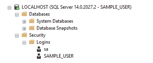

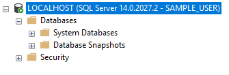

This is what the SAMPLE_USER sees when I implement Option 1. It does not expose the SAMPLE database to the SAMPLE_USER Login, even though it is mapped. This does not work.

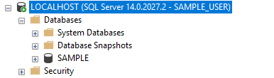

This is what SAMPLE_USER sees when I implement Option 2. This works, however, it changes the database ownership which I cannot allow.

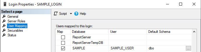

    Use the server level login (SAMPLE_LOGIN) to set its Mappings to include the SAMPLE database.

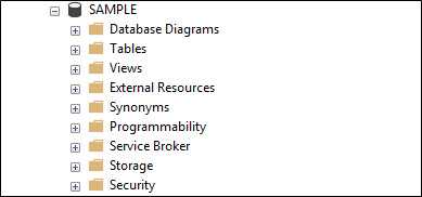

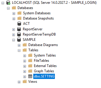

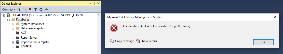

    Here you can see what my SAMPLE_LOGIN sees at the server level (everything) while it throws an error if I try to access any database…
    In contrast, when SAMPLE_LOGIN tries to access a database that it is mapped to (as SAMPLE_USER is a database level user account that links to the server level SAMPLE_LOGIN), it can see the objects inside that database that have been granted to it under database user’s Securable permissions.

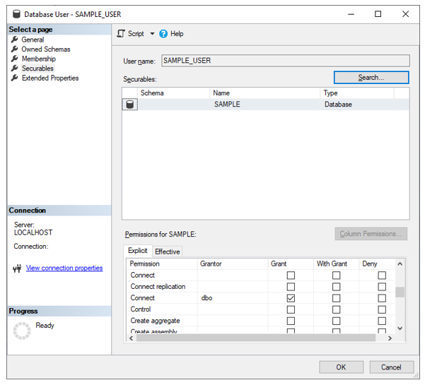

  1. Rob Jarrett 96 Reputation points
    2021-01-06T18:11:38.137+00:00
    Background:
    Here is my source database.

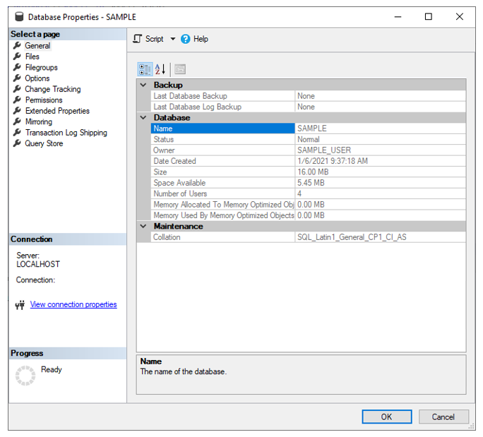

    When we look at the database properties, it has my domain\user account as the owner, because I created it.

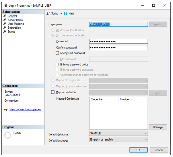

    I then created a SAMPLE_USER account with login to allow me to connect into SQL server (using SQL Authentication and the SAMPLE_USER login).
    However, when I connect using that account, the database is not visible.

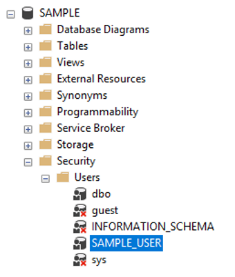

    The SAMPLE_USER database user account is linked to the server level SQL Login of the same name.
    It owns no schemas. This is a viewer, not an owner…
    It has db_datareader permissions…
    It has connect permissions to the database…

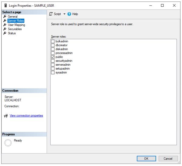

    Looking at the SQL Login level
    It is in the public role.
    It is mapped to the SAMPLE database. Note:
    Finally, the SQL Login has connect permissions on my local machine.

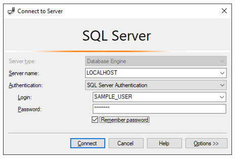

    When I connect to the server, I use the SAMPLE_USER login…
    So, this represents Option 1.
    This is the script for Option 2.
    As mentioned previously, this works, but…
    It changes the ownership. This is not allowable. I don’t want SAMPLE_USER owning it, but simply connecting and viewing it.
