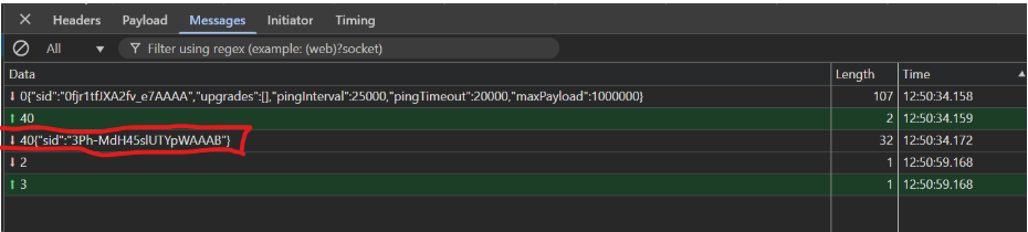

  • When running Socket.io locally, the client correctly receives the 40{"sid":"<socket_id>"} message, meaning the connection is successfulUser's image

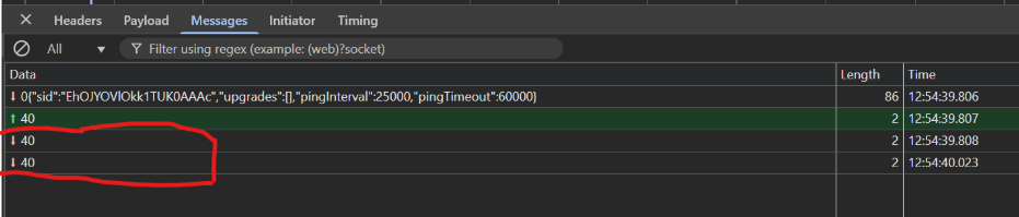

  • When connecting to the AKS-deployed server, the client only receives 40 without the sid, and the connection does not completeUser's image
  • The issue happens over wss://, but the same client works fine when connecting to a local server.
