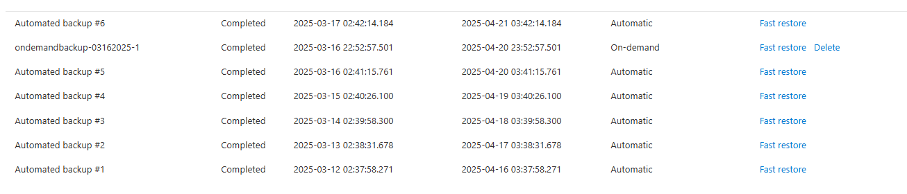

I was doing a test of the preview feature 'on-demand' backup for Azure PostreSQL flexing instance.
When I clicked "Backup (Preview)" option under Settings ==> Backup it started the backup as expected but I noticed that the Flexible instance status turned from "Ready" to "Updating"
Any reason why the database goes down when backup?

  3. subhash-DBA 135 Reputation points
    2025-03-17T23:02:09.23+00:00
    Thanks a lot again for your responses @Mallaiah Sangi
    So, if this is(Write pause) part of daily backup, then - what is the impact to connected applications/clients during that time?
    Note that there are no option to schedule automated backup from customer side, it happens automatically. For example, for our workload running for Australia the backup timings are in the middle of the day (times show below are in UTC). so wondering how that impacts to our transaction
  4. subhash-DBA 135 Reputation points
    2025-03-18T08:22:01.9466667+00:00
    @Mallaiah Sangi
    I think you are not answering the questions , let me phrase it this way.
    1. What's the impact to connected applications/sessions/clients when backup happens (backup leads to 'write pause') . You have mentioned earlier that 'write pause' happen for both on-demand and 'automated daily' backup.
    2. Scheduling the backup 'non-business hours' : There are no options to schedule "automated backup" (the default snapshot backup i mean) for Azure PostgreSQL flexible instance. So what do you mean by the best practice of scheduling backup ?
