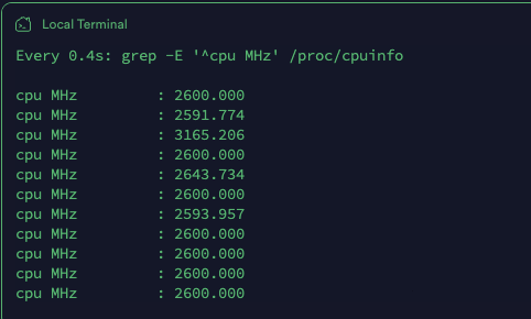

  1. Cerebro Agent 20 Reputation points
    2025-03-31T02:16:45.8933333+00:00
    (posting again because I don't see the first message)
    Hi @Pramidha Yathipathi ,
    Thank you for your prompt response. I appreciate your recommendations, which did help improve speeds, but unfortunately, the maximum 2.8GHz isn't sufficient for my needs.
    I was running five servers, but the CPU speeds aren't fast enough for the blockchain production requirements of two of them. Therefore, I will need to migrate a second server from Azure to Contabo.
