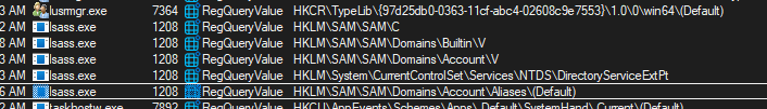

    Actually this issue is not limited just to docker, after an update restart a few days ago I got a similar situation. MMC does not list any group, net localgroup does list the groups, but I cannot add modify or delete any group or membership.
    SFC scannow says everything is ok.
  3. Diego M 0 Reputation points
    2025-03-20T14:19:13.55+00:00
    Found my issue in case it helps, my SAM went bad somehow after last windows update.
    This entry would be
    [HKEY_LOCAL_MACHINE\SAM\SAM\Domains\Account\Aliases]
    Instead of (as I compared with other working systems to be have a reference
    @=hex(0):
    Created a new reg file and imported it with a task running as SYSTEM. All good now!
    The way I got to this is by tracing events, then concluding there was a problem with SAM, and finally monitoring registry activity while reproducing the issue with procmon, which revealed that in any tests I would do Aliases would be the last call before the error
