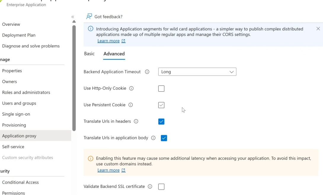

Shabin Suresh • 211 Reputation points
2025-04-03T06:10:58.1133333+00:00 Hi @Goutam Pratti ,
In Azure this is the setting and still we have the issue.
Kindly advise.
Thanks,
