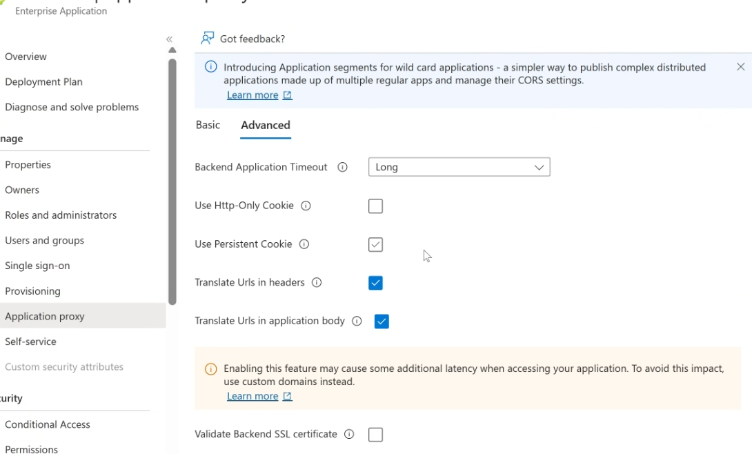

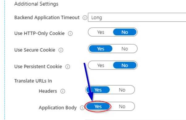

    hi , you need to make sure the server should include headers like : Access-Control-Allow-Origin: https://hrweb.contoso.com
    Access-Control-Allow-Methods: GET, POST, PUT, DELETE
    Access-Control-Allow-Headers: Content-Type, Authorization
    Also , try to update the application proxy body like in the image i shared application proxy settings If the reply is helpful, please click Accept Answer and kindly upvote it. If you have additional questions about this answer, please click Comment.
