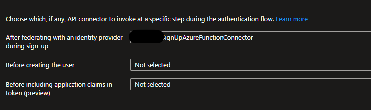

I am able to create the user accounts. I have created a API Connector for my Azure Function. I am using > After federating with an identity provider during sign-up.
I am using ngrok to help with triggering the Azure Function locally.image

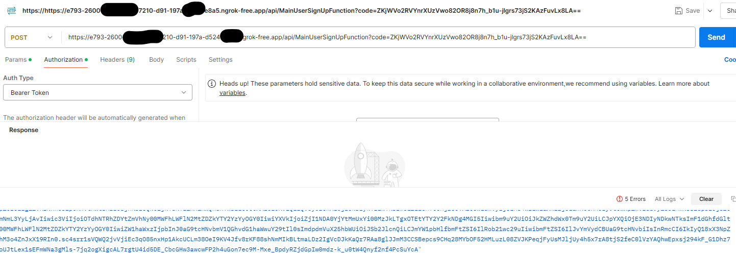

I am able to use postman to trigger the Azure Function using the token in the screenshot below.
My problem is that when I try to run the user flow SignUpSignin policy. I am able to get the token but the token is not being sent to the Azure Function and the Azure Function is not getting triggered.

    Based on your query, here is my understanding: I see you would like to authenticate Function app using Azure AD B2C.
    I believe the configuration was successful if you are receiving the token from Azure AD B2C, but I would like to check few more points to make sure you call the correct redirect_URI in order to invoke the function app using the access token.
    Please cross check the below steps and perform the necessary actions to achieve the end goal:
    1. While configuring an application in App registration, configure application as Web app. please make sure you add your function app complete URL (retrieve it from the overview of function app) and extend this as follows: {YOUR-FUNCTION-APP-URL}/.auth/login/aad/callback.Here kindly chooseImplicit flowfor authentication.
    2. While adding Azure AD B2C, you need to choose Entra ID (Formerly Azure Active directory) as authentication and go to advanced settings. Here it will ask you to provide Issuer URI and Client ID. Here the Client ID should be the one you are using to retrieve the token and the Issuer URI should be the sign up and sign in URL.
