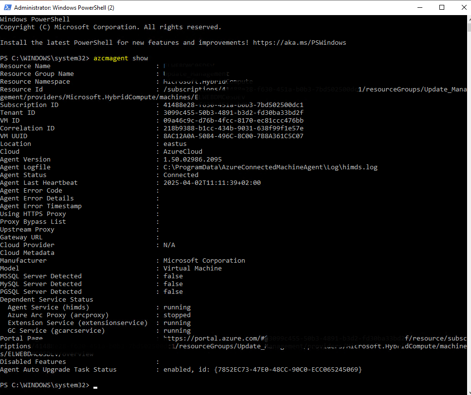

Ashok Gandhi Kotnana • 10,350 Reputation points • Microsoft External Staff • Moderator
2025-03-20T14:02:22.2066667+00:00 Hi Marina I,
Thanks for the response back.
The warning messages in your
himds.log
indicate that there might be an issue with the authentication headers being sent to Azure services. Here are some steps you can take to troubleshoot this issue further:Can you please check
azcmagent show
when you hit above command you need to get the below service running
Agent Service (himds): running

Marina I • 1 Reputation point
2025-04-02T09:22:10.34+00:00 Appologies for the delay in anwering. I have been on Disaster Recovery Exercises.
Result for azcmagent show:
There does not seem to be any errors for the agent.

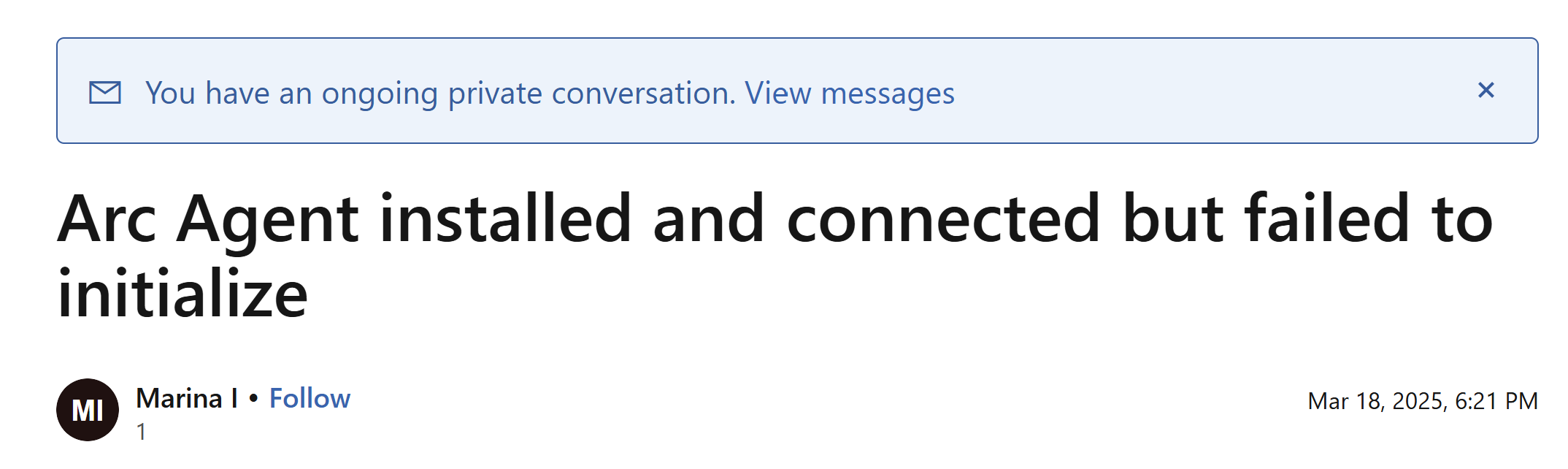

2025-04-03T10:10:50.7033333+00:00 Hi Marina I, I understand that you are still facing the issue. I initiated a private chat asking few details to connect with you for further investigation on the issue. Please respond there.
Madugula Jahnavi • 495 Reputation points • Microsoft External Staff • Moderator
2025-04-04T15:33:30.89+00:00 Marina I, We haven't heard any response from you. Can you please provide the required details to connect for further investigation.
2025-04-08T06:04:24.5333333+00:00 Hi @Madugula Jahnavi . Sorry, but I dont know where the private chat is. Where do I find it? This is my first time on these forums.

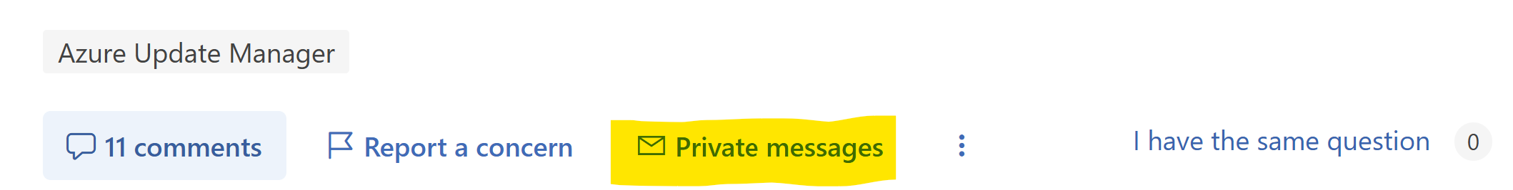

SadiqhAhmed-MSFT • 49,331 Reputation points • Microsoft Employee • Moderator
2025-04-25T07:09:30.86+00:00 @Marina I You will see private message option on top of thread title. See the snippet below:
You will also be able to see the private message option below your original post.
Hoping to hear back from you on the status of the issue. If this is still an issue, please share the details asked in the private message.
