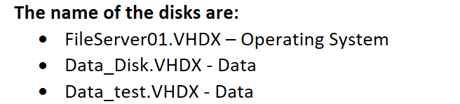

    Please find how it worked in my lab:
    I have a Hyper-V VM with three disks.
    From DPM PoweShell I set this:
    Set-DPMGlobalProperty -DPMServerName DPM2016MBS -HyperVPagefileExclusions "Data*.vhdx"
    Then I checked the status by this way:
    Get-DPMGlobalProperty -PropertyName HyperVPagefileExclusions
    Result: Data*.vhdx
    With this I will exclude all the VHDs with name DataXXX.VHDX from the backup. Keep in mind that the initial backup will contain all the data. The next backup will not.
