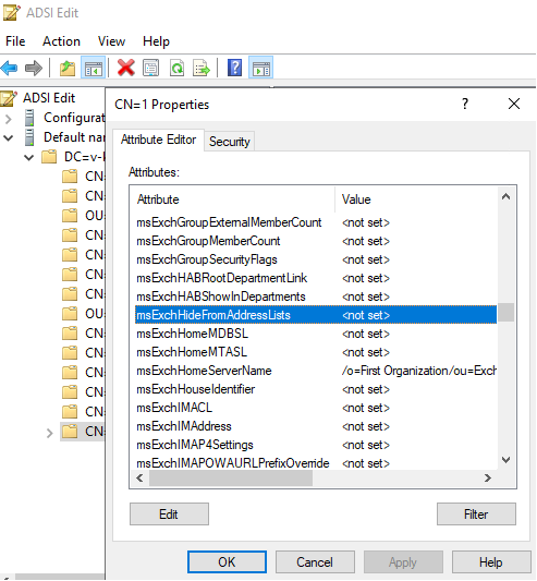

    To resolve this issue, you will need to run PrepareSchema and PrepareAD, and once you have done so, your AD environment will have the appropriate Exchange properties (see below). Detailed information on preparing AD and domains can be found in the documentation: Prepare Active Directory and domains for Exchange Server, Active Directory Exchange Server, Exchange Server Active Directory. Exchange 2019 Active Directory | Microsoft Learn
    After you have successfully added the attributes, you can set them with the help of the ADSI editing tool, or by using PowerShell commands. Subsequently, synchronize these settings to Azure AD via the AD Connect tool, thus achieving the goal of hiding users in the address list.
