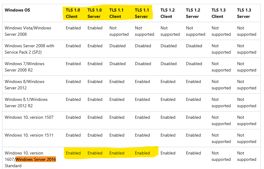

    From the link below, I can see the TLS 1.0 client, TLS 1.0 server, TLS 1.1 client and TLS 1.1 server are supported.
    Protocols in TLS/SSL (Schannel SSP)
    https://learn.microsoft.com/en-us/windows/win32/secauthn/protocols-in-tls-ssl--schannel-ssp-
    You can try to enable TLS 1.0 and 1.1 via registry.

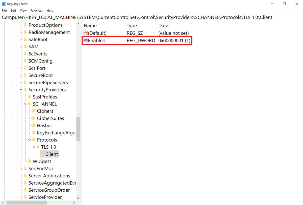

    The following DWORD registry values can be created to enable TLS 1.0 and 1.1 versions system-wide:
    HKEY_LOCAL_MACHINE\SYSTEM\CurrentControlSet\Control\SecurityProviders\SCHANNEL\Protocols\TLS 1.0\Client\Enabled
    HKEY_LOCAL_MACHINE\SYSTEM\CurrentControlSet\Control\SecurityProviders\SCHANNEL\Protocols\TLS 1.1\Client\Enabled
    HKEY_LOCAL_MACHINE\SYSTEM\CurrentControlSet\Control\SecurityProviders\SCHANNEL\Protocols\TLS 1.0\Server\Enabled
    HKEY_LOCAL_MACHINE\SYSTEM\CurrentControlSet\Control\SecurityProviders\SCHANNEL\Protocols\TLS 1.1\Server\Enabled
    For example:
    The following example shows TLS 1.0 client set to the Enabled state:Screenshot of Set TLS 1.0 client-side to enabled in Windows Server registry setting.
    In order to override a system default and set a supported (D)TLS or SSL protocol version to the Disabled state, change the DWORD registry value of Enabled to "0" under the corresponding version-specific subkey.
