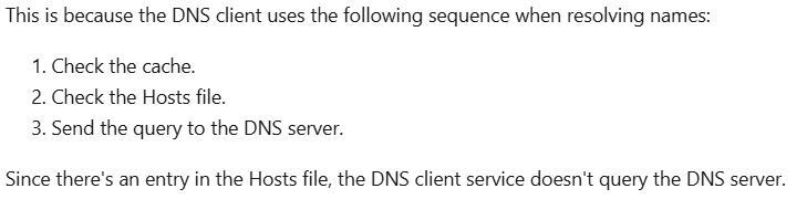

    From the information you provided, NDS parsing is incorrect. I suggest that you open a command prompt as an administrator and run the following command to clear the DNS cache to see if it can solve the problem:
    ipconfig /flushdns
    ipconfig /registerdnsUser's image
    Reference link:https://learn.microsoft.com/en-us/troubleshoot/windows-client/networking/troubleshoot-dns-client-resolution-issues?source=recommendations
