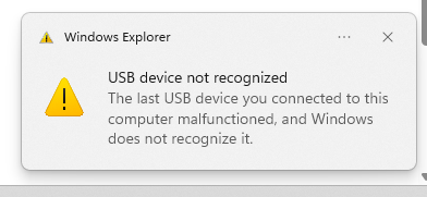

It is constantly telling me that a USB device is not working, but I have unplugged every cable I have plugged in one at a time and it just keeps doing it.

    Hello,
    Thank you for posting in Microsoft Q&A.
    Based on the description, I understand your question is related to computer keeps basically making a ping pong noise.
    Ensure that the application or service triggering this error has the correct permissions. Right-click on the application or service. Select "Properties" > "Security" tab. Ensure that permissions for Administrators, System, and Users are set to "Allow Full Control".
    Open Command Prompt as Administrator. Run below comands:
    sfc /scannow
    chkdsk /f /r
    Check that all cables connected to your hard disk are secure. If possible, try using a different cable or port.
    Update your drivers, if Driver Verifier has detected a specific one, you can update that driver and see if that fixes the problem. Press Windows + 'R' and type devmgmt.msc to open Device Manager. Locate the device and double-click on it to expand. Double-click on the driver and go to the Drivers tab. Click "Update Driver" and select "Automatic Search" for drivers.
