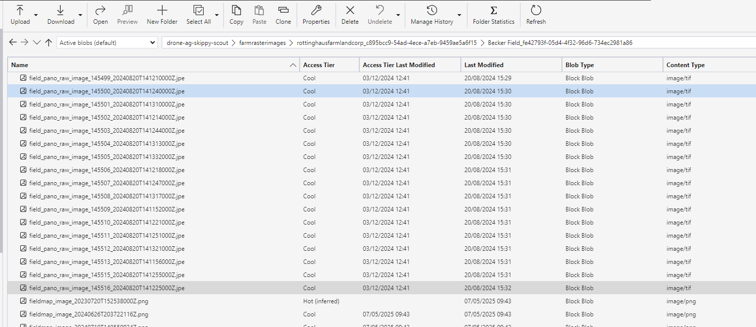

We noticed we weren't seeing any updates in our SQL database which suggested that the functions were not running.
We opened Staging App and we could see from the stats that it had no runs for at least 30 days. However, based on our database it was 4 months without running.
When we refreshed the function app invocations page, suddenly runs started appearing. It was rapidly processing all the blobs it had not processed in the last 4 months.
We similarly have the same issue on production with Production App. We were able to recreate the issue this morning. I opened the Invocations tab today (16th April 2025) and it indicated that Production App had not run since 26th March 2025.
Coincidentally, it is worth noting that the 26th March 2025 was the same day that I opened the Invocations tab of the Staging App.
I have refreshed the invocations and it is now rapidly processing a backlog of blobs. It has processed thousands of blobs within the last 30 minutes. Due to the size of the backlog it is still processing more blobs.

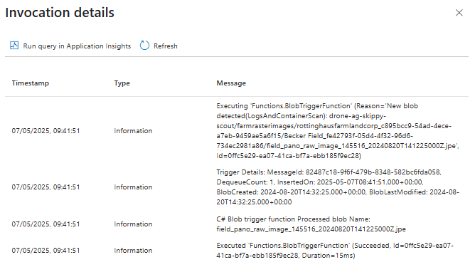

2025-05-07T08:59:56.3966667+00:00 Hi again,
Was something done to the function app on Azure's side? It is reprocessing ever blob - including blobs which have already been processed. Blobs last modified in 2023 are now being processed even though they shouldn't be.
I've including the details from Operation 8734d7f5f3529f10ab19fe21ece2146b below. You can see that the relevant blob (in grey) was last modified in 2024
