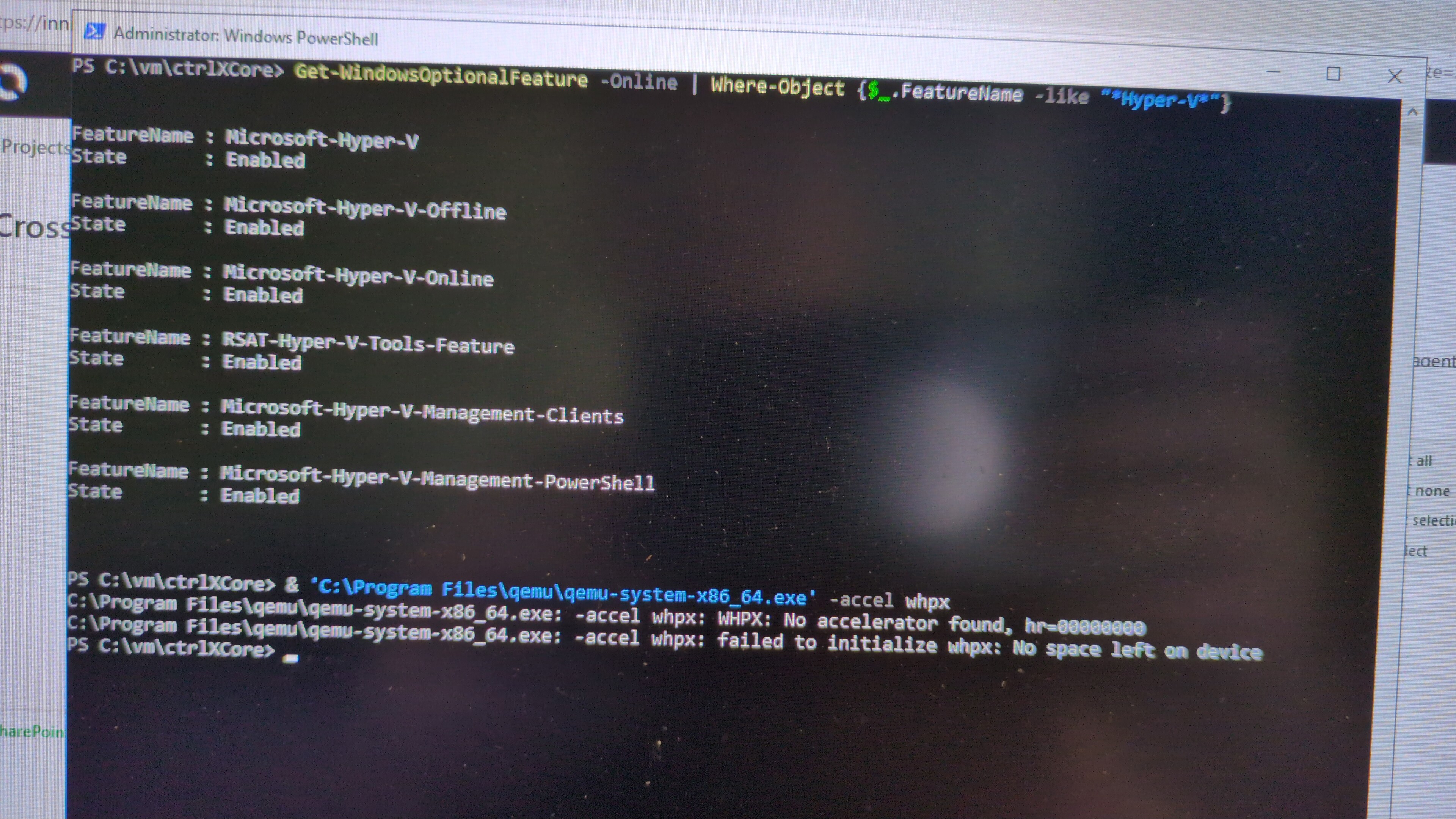

I have a virtual PLC which runs using qemu with whpx acceleration. I am looking if it is possible to run this in a cloud environment.

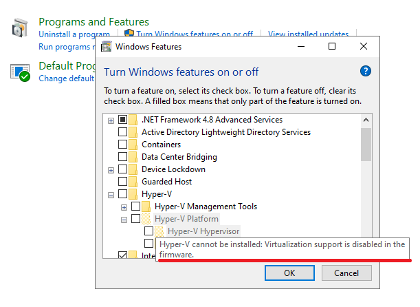

    As per the screenshots you have shared so far, I can see in screenshot 1 that the error says "Hyper-V cannot be installed: Virtualization support is disabled in the firmware"
    Reason- The Azure VM does not have nested virtualization enabled, or the VM size does not support it.

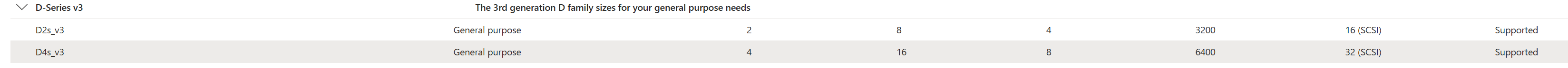

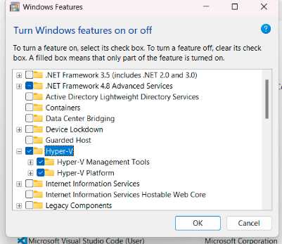

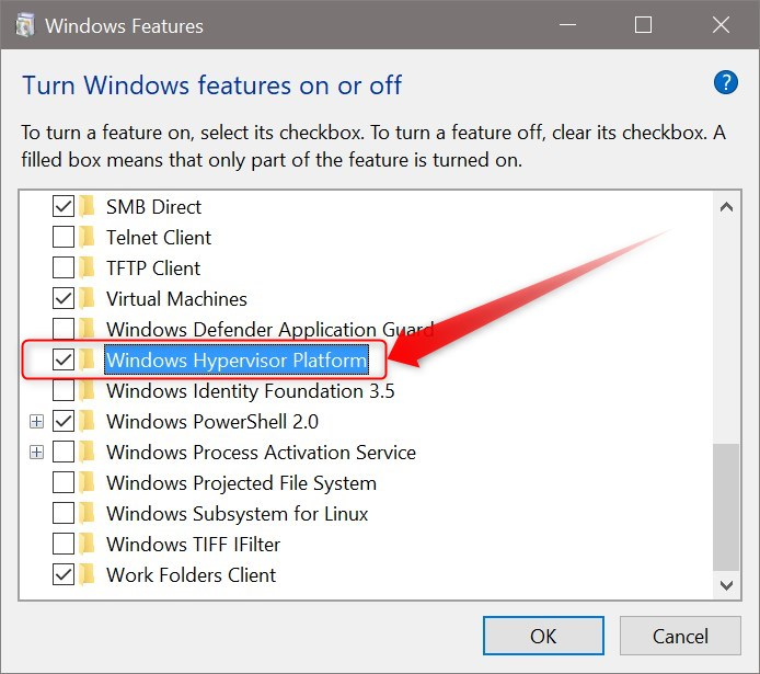

    In your screenshot 2 and 3 you highlighted that PowerShell shows Hyper-V features are enabled, but the qemu-system-x86_64 fails with error- failed to initialize whpx: No space left on device and Windows Hypervisor Platform is enabled.
    But it does not guarantee WHPX will function inside Azure VMs
    Why? What are the limitations then?
    Azure VMs like Dv3/Ev3 support Hyper-V-based nested virtualization, but the WHPX driver may not initialize correctly inside these VMs because Azure controls the host hypervisor and does not expose all VT-x instructions needed for WHPX to work inside the guest. Please note that Nested VM -> WHPX -> Virtual PLC is a triple-layer virtualization—Azure -> Hyper-V VM -> QEMU with WHPX which is not a supported path.
