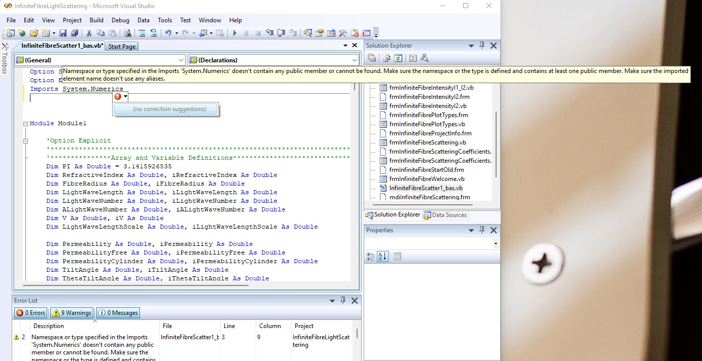

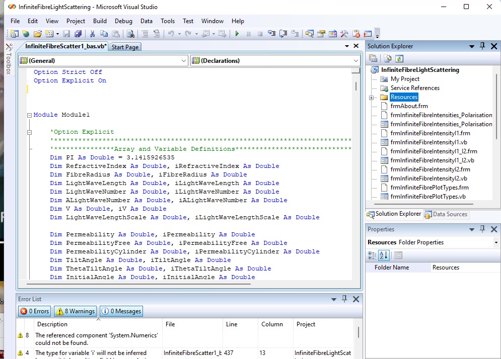

I managed to download Systems.numerics.dll file from URL https://www.dllme.com/dll/files/system_numerics. Then I added it as a reference in my project solution. I saw an error message in my Visual Studio project Module.bas "Warning 8 The referenced component 'System.Numerics' could not be found." even when I added the reference.
The Import System.Nurmerics is not recognised. I thought if I downloaded and installed .NET 4.8 from here - Downloaded and installed .NET 4.8 from

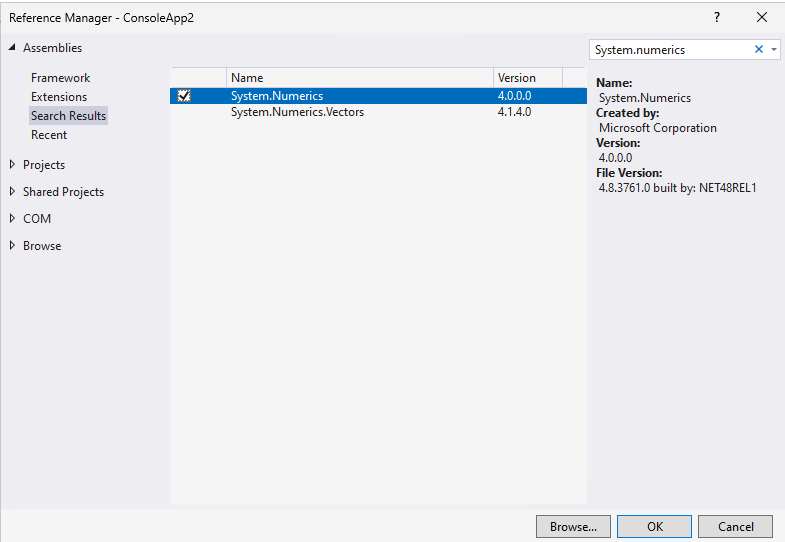

    To add a reference to an assembly in your project, so you can import the namespace, go to the References node in Solution Explorer (or project properties if yo uprefer) and add an assembly reference to System.Numerics. It is already installed on your machine, just add an assembly reference to it (VS will show you the only one that is available to you). Then the namespace will be available and your Import, in the source file, will bring into scope the types available in that namespace.

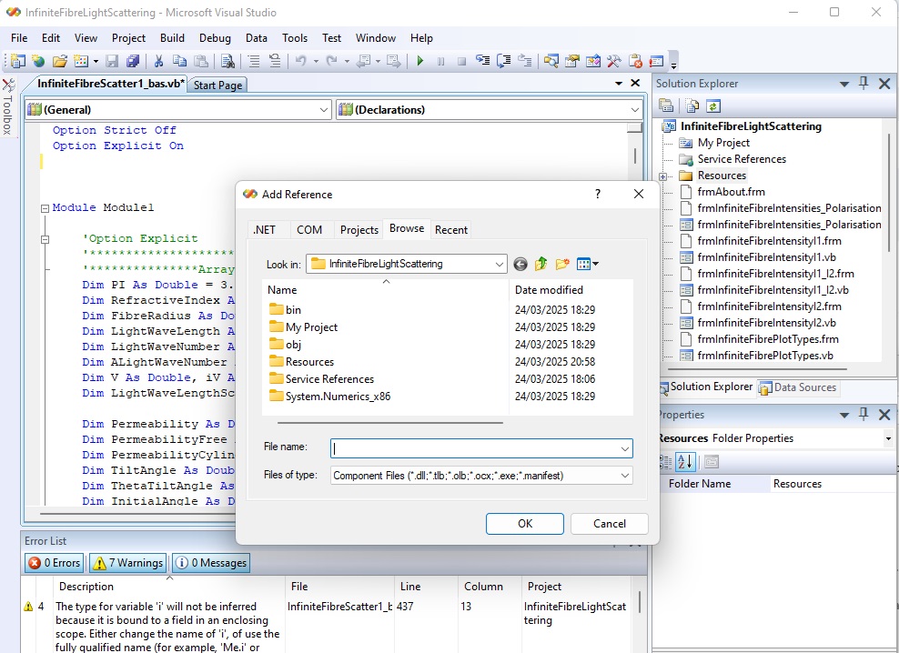

    1. How you added the dll file. The attachments go through how i did this in my current project. I had a copy of the system.numeric.dll within my projects folder.
    1. How you added/imported it to your project to use it - My last 2 attachments show that I tried to use the Imports System.Numerics command line at the top of my module with the error message I get when it cannot be found.
    2. My Project is based on the .NET 3.5 Framework. I tried to get .NET 4.5 but i get a message saying its already part of my Windows 11 OS. Rebuilding my project does not remove the warning regarding system numerics.System Numerics Issue for Microsof Q and A Forum - 5.jpg
