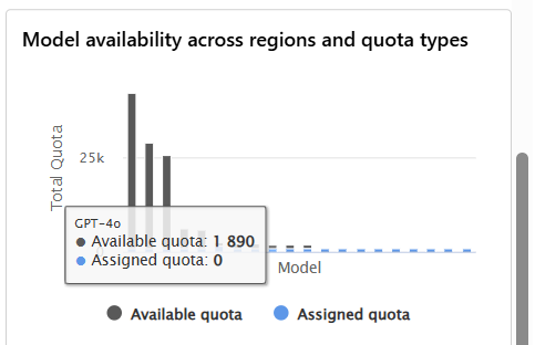

In addition, why does our assigned quota become 0 as shown in the picture?

    4.Assigned Quota Showing 0
    Observation: The screenshot shows an assigned quota of 0, while available quota is high.
    Explanation:
    Assigned quota = actual usage limits you can allocate.
    Available quota = the maximum you could assign but is not yet allocated.
    If assigned quota is 0, it means your deployment hasn’t used any quota yet or is not correctly assigned.
    Solution:
    Check your Azure subscription and quota allocation settings.
    Assign the required quota to your OpenAI deployment in Azure Portal → Quotas & Limits.
    Run az openai quota list in Azure CLI to verify quota assignment.
