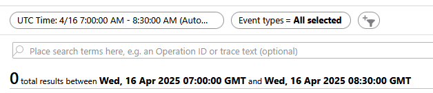

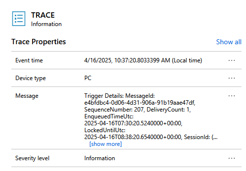

An Azure Functions app using a Consumption plan has been experiencing significant delays, sometimes taking hours for messages to be handled after being enqueued. The Functions app was not running during these delays, and Application Insights logs have been reviewed without finding the issue (there were literally no logs between the enqueue time and the processing start time, which took a few hours this morning). Additionally, the visibility settings on the messages confirm they are visible immediately upon being pushed to the queue.
