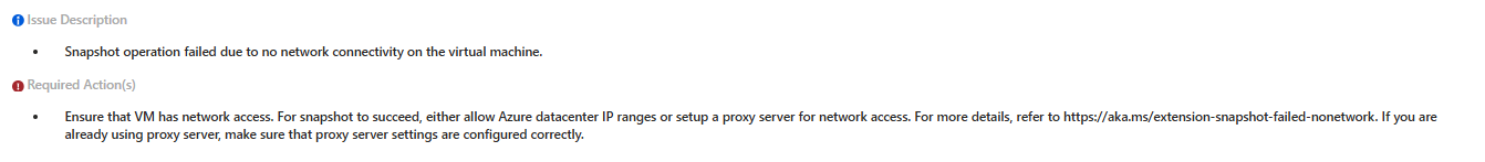

Error Code:ExtensionSnapshotFailedNoNetwork
Error: Snapshot operation failed due to no network connectivity on the virtual machine.
