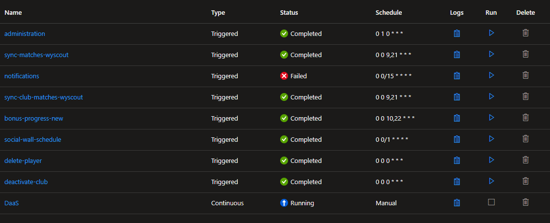

I have an Azure App Service (Web App - Windows), with a bunch of triggered WebJobs, all written in Node.js. The App Service has 3 deployment slots - 1 for production and 2 for testing/staging purposes.
All of them are working as expected, but for some time one in particular, on the staging slot, keeps failing.User's image
No execution errors, just:
[04/02/2025 14:01:09 > a6c961: SYS INFO] Status changed to Failed
[04/02/2025 14:01:09 > a6c961: SYS ERR ] Job failed due to exit code 1
All the others are still working fine, even the same job on the other two slots.
I tried both upscaling and outscaling the App Service, since when this job was triggered, at one point it reaches a CPU level close to 100%, but with no success.
It is not a timeout error since the job fails after 2 mins (usually taking 3-4 mins).
If I launch the code locally on my computer, it works as expected so I cannot be an error on code-level.
Any helps is appreciated. Thanks

  1. Piercarlo Serena 20 Reputation points
    2025-04-04T09:18:56.92+00:00
    Ok I found the cause and the solution.
    Cause: it was caused by an updated version of Pino (only on staging, for the moment), our logging library. The process was exiting without flushing the transport.
    Solution: deactivate Pino on production, since it's not even used on the WebJobs dashboard.
    That also explains why on production slot was working. Still doesn't explain why only this job is affected while the others not, but whatever.
    Thanks for pointing me out where and how to dig deeper into this!
