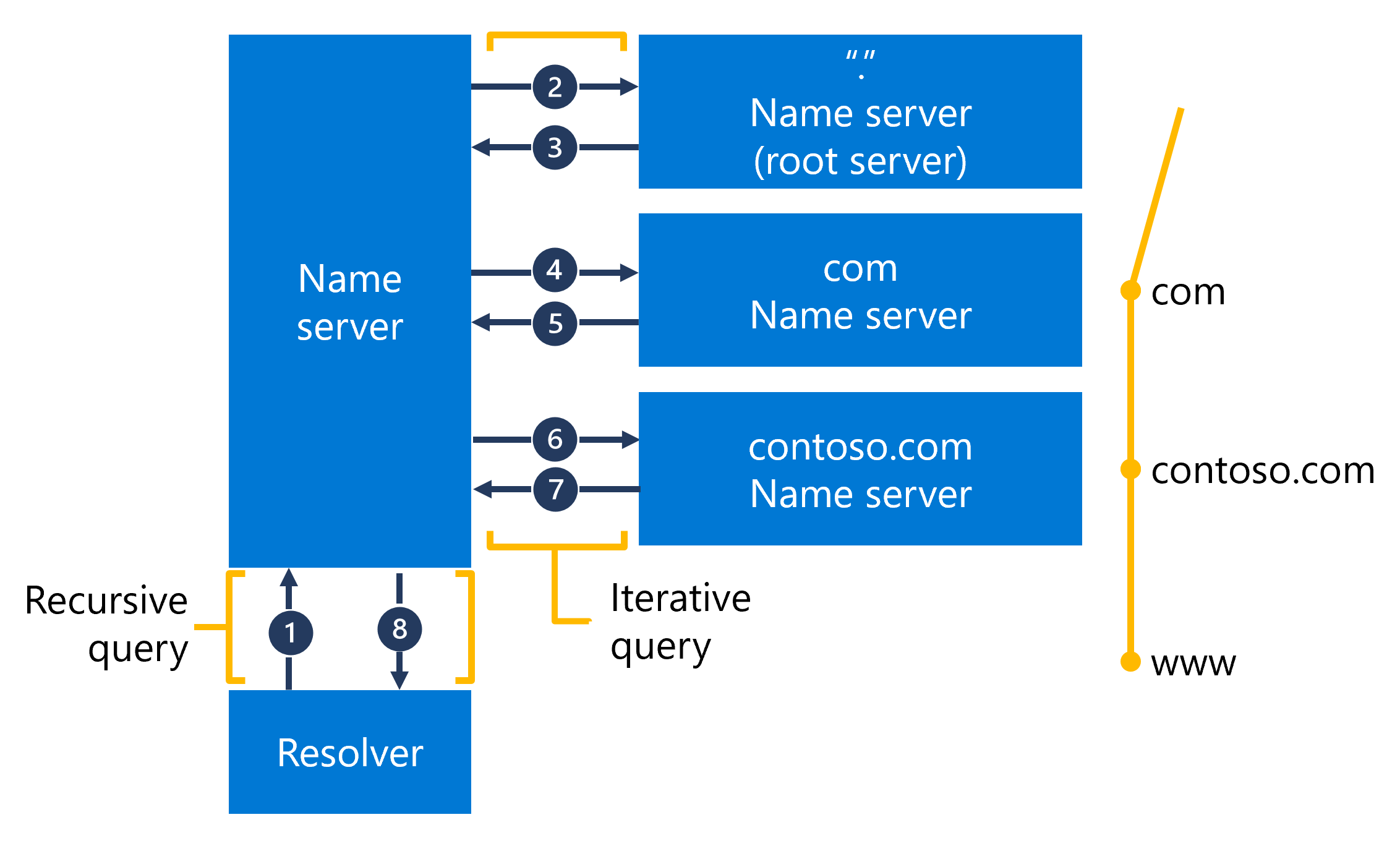

    The following figure shows an example of both types of queries.
    The diagram shows how multiple queries were used to determine the IP address for www.contoso.com.
    The diagram shows how multiple queries were used to determine the IP address for www.contoso.com. The query sequence is described as follows:
    1. Recursive query for www.contoso.com (A resource record).
    2. Iterative query for www.contoso.com (A resource record).
    3. Referral to the .com name server (NS resource records, for .com); for simplicity, iterative A queries by the DNS server to resolve the IP addresses of the Host names of the name server’s returned by other DNS servers have been omitted.
    4. Iterative query for www.contoso.com (A resource record).
    5. Referral to the contoso.com name server (NS resource record, for contoso.com).
    6. Iterative query for www.contoso.com (A resource record).
    7. Answer to the iterative query from contoso.com server (The www.contoso.com IP address).
    8. Answer to the original recursive query from local DNS server to resolver (The www.contoso.com IP address).
