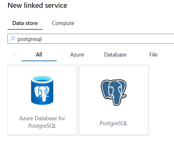

  1. Harrie Kierkels 0 Reputation points
    2025-04-08T09:50:09.51+00:00
    We had the same problem with all PostgreSQL tables in combination with SHIR 5.48.9106.2.
    In ADF you can choose between two connectors: "Azure Database for PostgreSQL" and "PostgreSQL".
    We've used the last one but we now switched to "Azure Database for PostgreSQL" and that solved our problem!
    2025-04-08 11_42_59-screenshot
