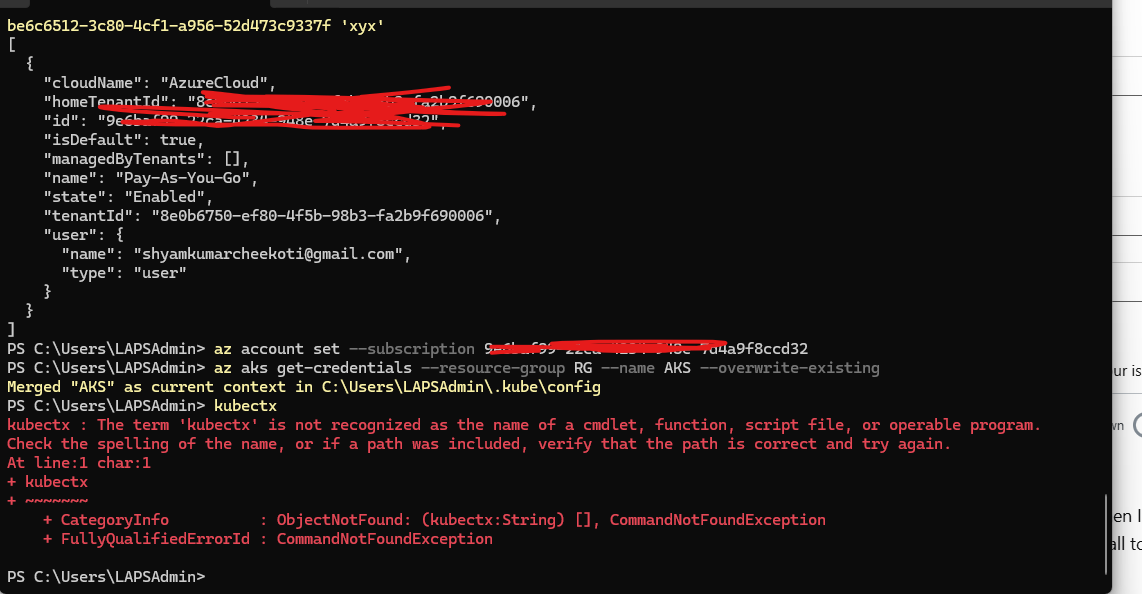

I have already connected to AKS from azure using azure cli from powershell,
but I want to execute below command to see AKS cluster is mapped to kubeconfig file,. but when I execute below command i am seeing below error. Please suggest tool link which I need to install to disappear below message

    The error in your PowerShell terminal is because the kubectx command is not installed on your system. kubectx is a separate utility from kubectl and is used to quickly switch between Kubernetes contexts.
    Try and install kubectx using chocolatey
    choco install kubectx
    Make sure you have chocolatey installed as well. Do this using https://chocolatey.org/install
