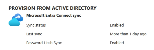

When I run the Sync Service tool i get this.... which looks good but I know its not actually syncing!
Help please!!
  1. Andy David - MVP 157.8K Reputation points MVP Volunteer Moderator
    2025-04-07T12:16:05.0466667+00:00
    Yea, one has to be exporting for this to work, the other needs to be in staging mode. Only one server can export at any one time
    Very important to check that one is set to export!
    https://learn.microsoft.com/en-us/entra/identity/hybrid/connect/how-to-connect-sync-staging-server#change-currently-active-sync-server-to-staging-mode
    So on both servers, run that command. If both are set to TRUE for StagingModeEnabled, then follow the instructions to set ONE of them to StagingModeEnabled to FALSE by running the wizard
    https://learn.microsoft.com/en-us/entra/identity/hybrid/connect/how-to-connect-sync-staging-server#change-current-staging-sync-server-to-active-mode
