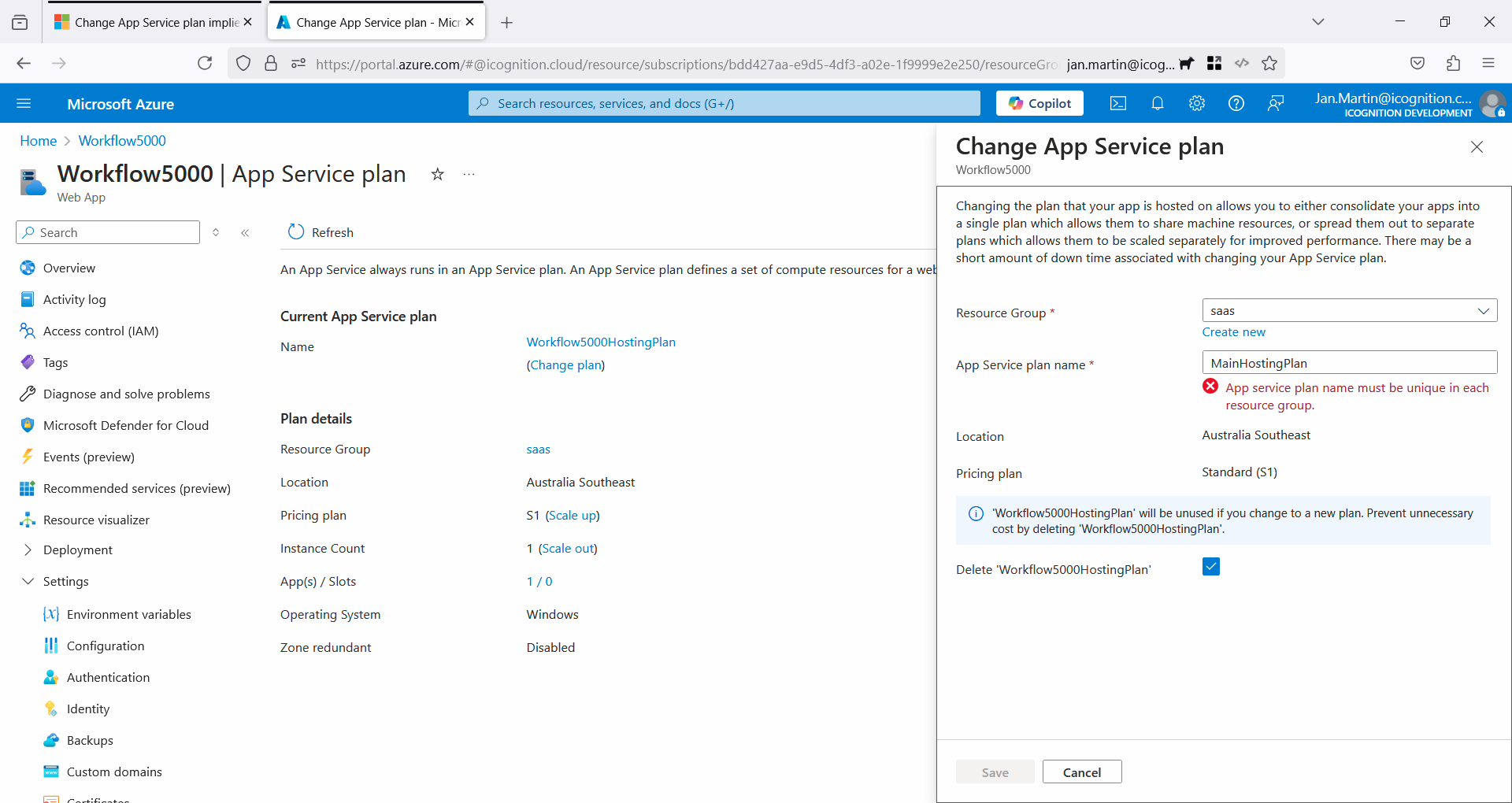

I have two azure app services and I'd like to put them on the same plan, at the moment they each have their own.

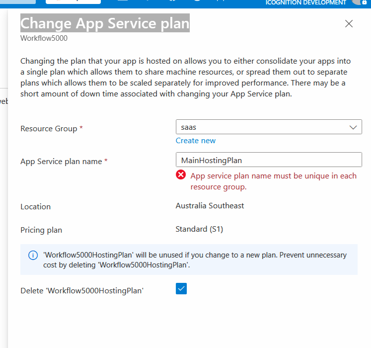

So I clicked on Change plan, a pop up appears that even says "Changing the plan that your app is hosted on allows you to either consolidate your apps into a single plan which allows them to share machine resources"
However, the form below it does not allow you to select an existing plan, meaning you can't do that - I even tried typing in the name of my existing plan, however I got an error message about it not being unique...

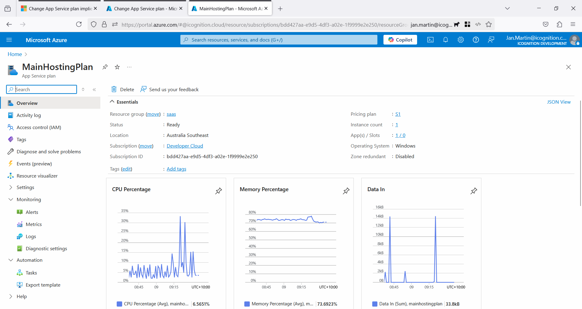

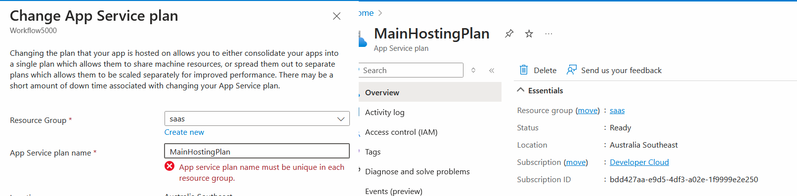

    UPDATE: The app service plans were originally in different resource groups and then later moved into the same resource group. That is why they are unable to be consolidated into the same app service plan. Please see discussion in comments below.

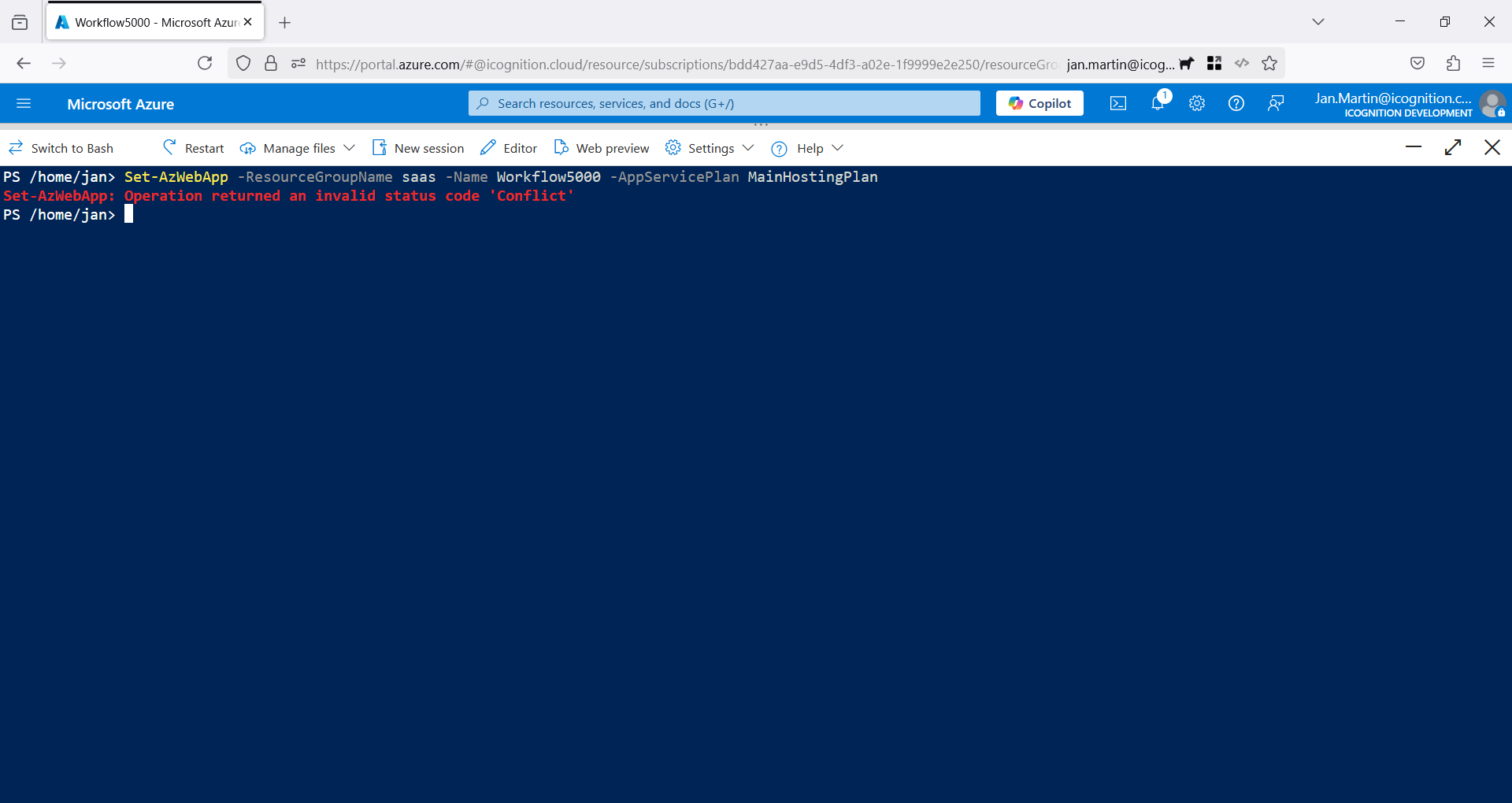

    Please execute below command in Azure Cloud Shell (PowerShell) and reply back with your results:
    Set-AzWebApp -ResourceGroupName saas -Name Workflow5000 -AppServicePlan MainHostingPlan
