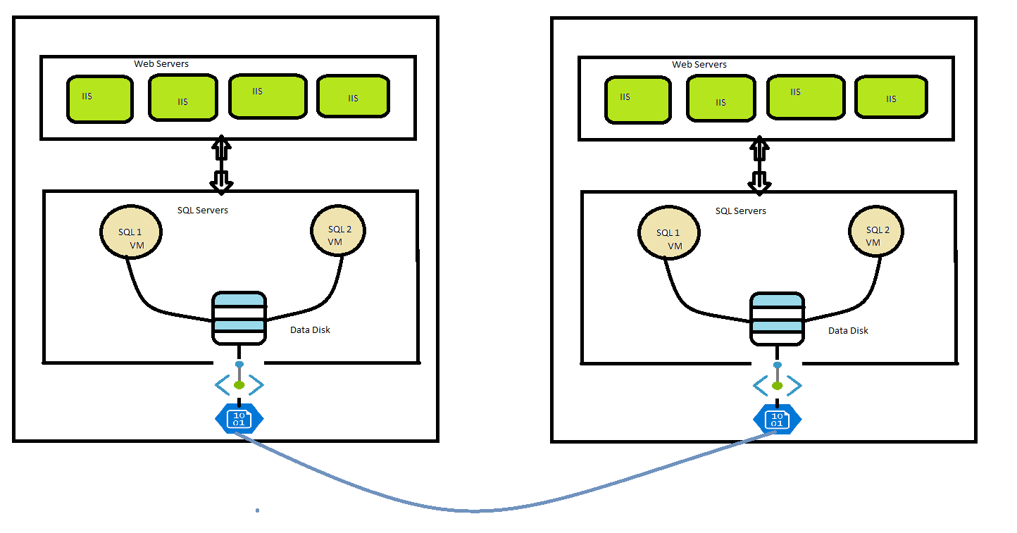

An SAP tool is hosted in Azure across two regions (one for primary and another for disaster recovery), with web servers and SQL servers in different subnets, as illustrated in the diagram below.
The plan is to migrate from hosted SQL VMs to Azure SQL Managed Instance (SQL MI). After reviewing Microsoft documentation, it was noted that there are four available migration options:

The database sizes are manageable, with three databases: one around 10 GB, another 150 GB, and the third is 160 GB. A combination of LRS and Database Migration Service (DMS) is intended to automate the end-to-end data migration (Assuming this would work)
However, there is confusion about how the "to-be" diagram would look after migration based on the current setup.

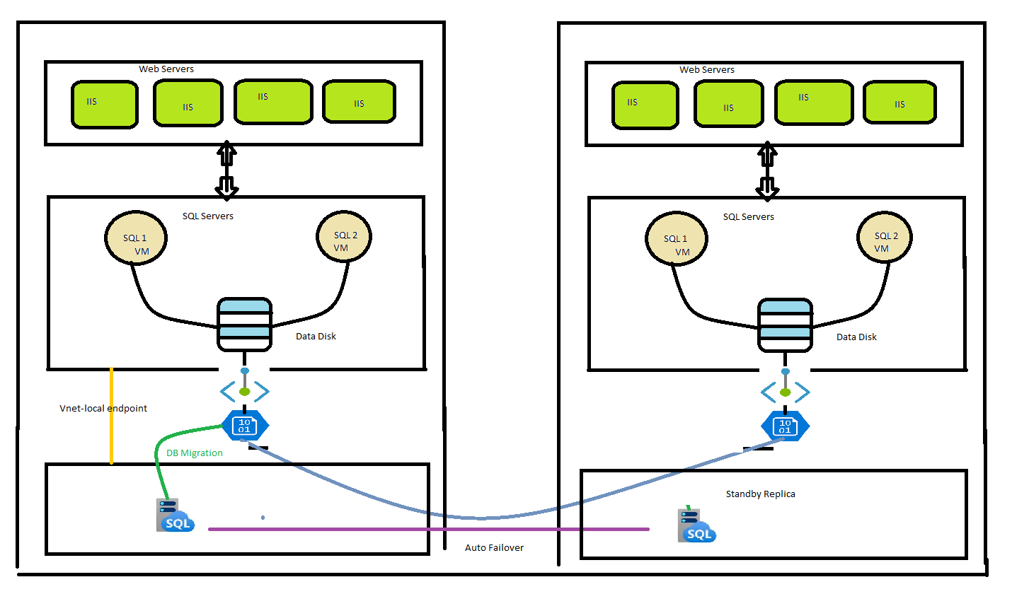

A note from Microsoft states the following:
  • Azure SQL MI requires a dedicated subnet. If this is the case, can a VNet-local endpoint be used during data transfer (for connectivity between the old SQL VM and Azure SQL MI)?

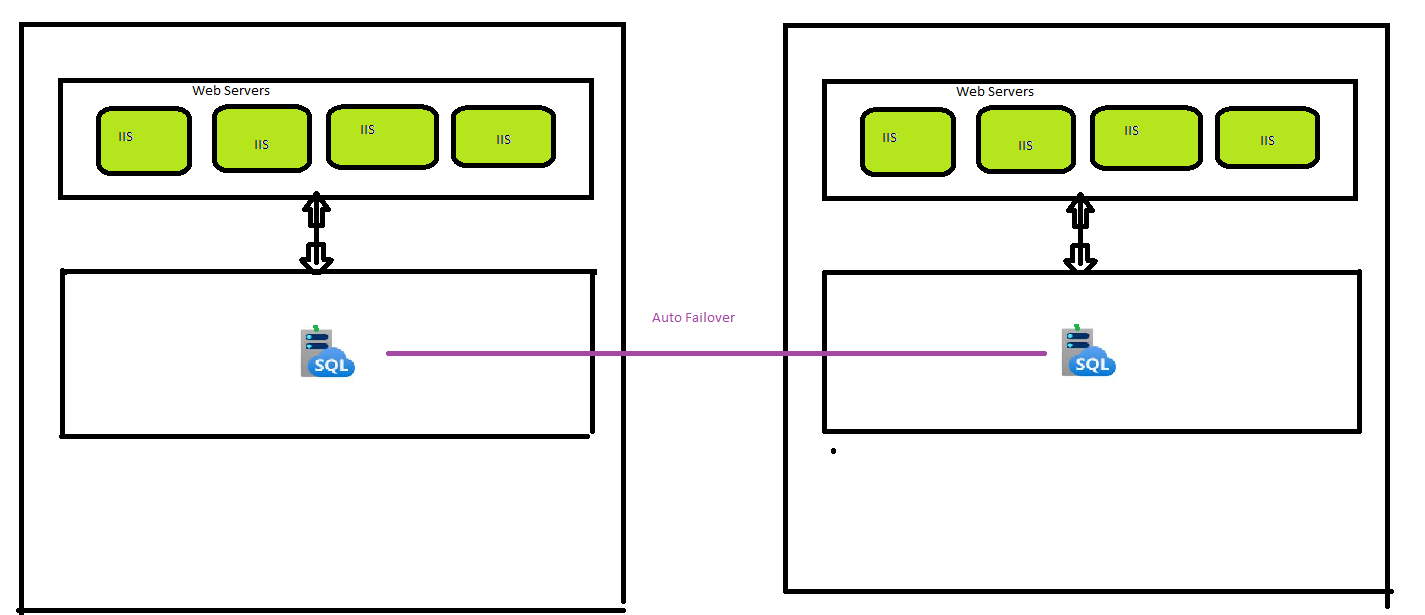

  • Given that there are two SQL servers enabled with Failover Cluster Instances (FCI), would one Azure SQL MI typically replace the need for multiple FCIs?
  • During the transition phase, is the data transfer from Azure Blob Storage to Azure SQL MI a straightforward process?
Apologies if the "to-be" diagram lacks clarity; it serves as a rough representation. Confirmation on these assumptions would be appreciated for a smooth migration process.

    Private Endpoints vs. FQDN for Firewall Scenarios Microsoft recommends utilizing Private Endpoints for secure and isolated connectivity between your web servers and Azure SQL Managed Instance (MI). This ensures that traffic remains within your virtual network, avoiding traversal over the public internet for enhanced security. If you choose to use an FQDN, please ensure that DNS resolution is correctly configured to route traffic to the private endpoint, which can be managed through Azure Private DNS Zones.
    VNet-local Communication Between Subnets Once the Azure SQL MI is placed in its designated subnet, communication between SQL Server (Subnet 1) and Azure SQL MI (Subnet 2) will utilize the VNet-local endpoint by default. This provides private communication within the virtual network itself, without requiring a separate private endpoint. A dedicated private endpoint is only necessary for scenarios involving resources across different VNets or for additional isolation.
    Data Migration Strategy For minimal downtime during migration, combining the Log Replay Service (LRS) with Azure Database Migration Service (DMS) is highly recommended. However, if zero downtime and instant switchover to the Disaster Recovery (DR) region are priorities, solutions like Failover Groups or Geo-Replication can be explored to ensure seamless migration and operational continuity.
    Decommissioning Existing Resources Yes, you are correct. Once data migration, connectivity, and configurations have been validated, the existing Azure Blob Storage and SQL VMs can be decommissioned. Azure SQL MI provides robust disaster recovery capabilities, including automated backups and high availability, ensuring data resilience and security moving forward.
