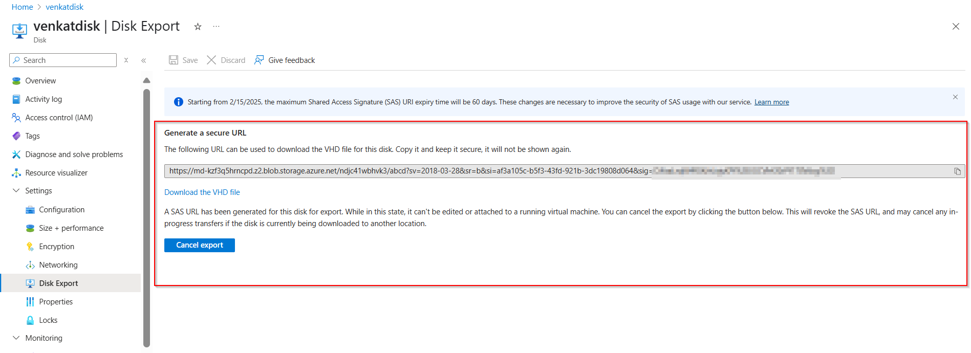

Thanks for the step-by-step guide. I've followed the instructions and successfully generated the disk export url and this time the command did run, but the job failed. I ran the commands on an azure VM. Here are the logs:
